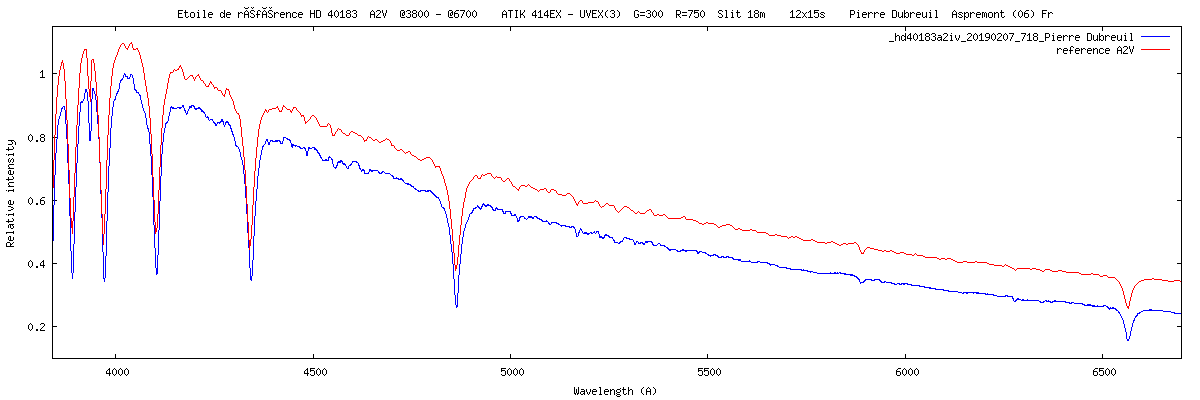

Etoile de référence:
Etoile de reference A2IV
compare A2V.png (8.32 KiB) Viewed 2993 times

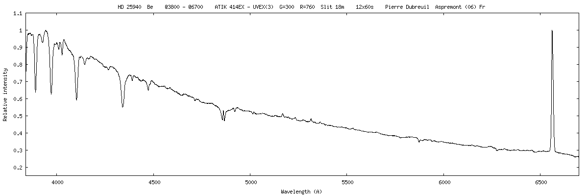

Be HD 25940
_hd25940_20190207_730_Pierre Dubreuil.png (5.7 KiB) Viewed 2993 times

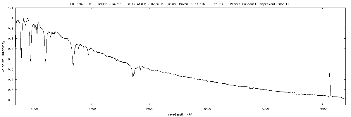

Be HD 32343
_hd32343_20190207_746_Pierre Dubreuil.png (5.76 KiB) Viewed 2993 times

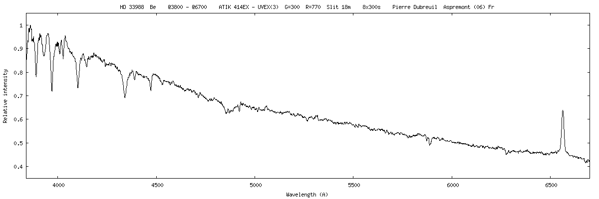

Be HD 33988
_hd33988_20190207_770_Pierre Dubreuil.png (6.27 KiB) Viewed 2993 times
Be HD 25940
