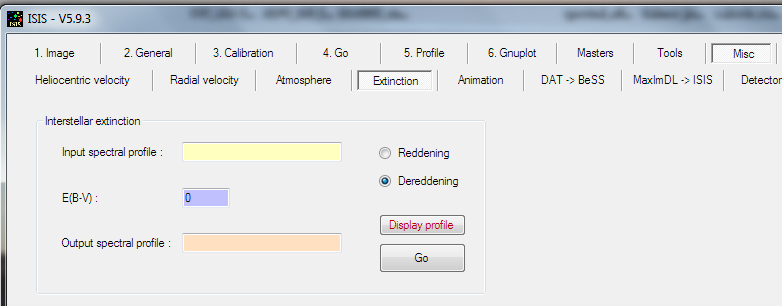

You can also use ISIS to see what your spectrum would look like without IS

actually, applying the average rate (1.1134), the profile changes
