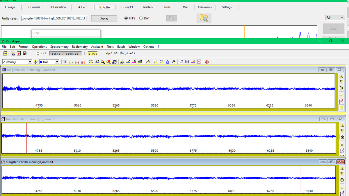

- I tried to reduce those waves bei changing the "binning zone" in ISIS but nothing
Hello to all,
I found, that ISIS seems to create strange effects, visible by extracting a 2D flat_tungsten. Look the adnex please. If I extract the same flat with midas those "fringes" are not visible!
Could anyone tll me something about this phenomena?
cheers Berthold

Ok, it could be that the light from the 200 mue fiber is not perfect centered over the pinhole, But!!!
I know a professional Astromer who reduced the SAME files with Midas and there is nothing to see from those "fringes" . Therefore It is nearly not possible that those phenomena are caused by my equipment.
This astronomer told me, that the "slit with" of the software is to small. One can change this slit with in Midas but not as fare I can see it is possible to change it in ISIS (?)
( I get no information via email if an answer is incoming here even if I have it switched on)

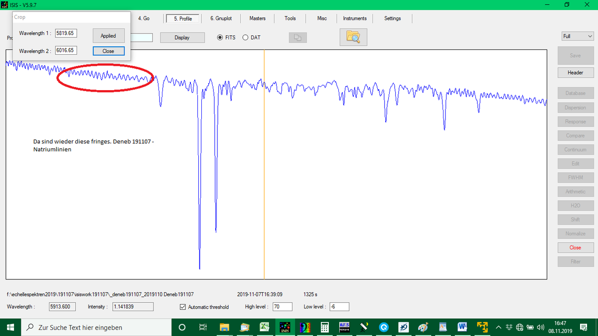

Posted: Fri Nov 08, 2019 7:01 pm
by Berthold Stober
- those "fringes" are not ok
[attachment=0]
I would like to publish there the ".....full.fit" 1D but this seems to be impossible.
berthold
Re: Bad efficiency of the eShel from shelyak
Posted: Fri Nov 08, 2019 7:11 pm
by Andrew Smith
Just some thoughts. Have you checked/cleaned the fibres? Do you shake the fibre to reduce modal noise. With my guide head I found misaligned calibration optics in the guide head I produced considerable modal noise.
Regards Andrew
