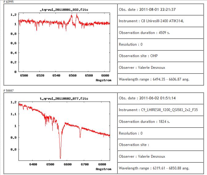

As seen in the ARASBeAm extract below, the outburst occured within couple of months. So the observing frequency currently set at 90days seems too low. Certainly should be increased at 30d or even 15d ? Of course, as soon as we do it... the next outburst will certainly wait ten years from now... :-)
I would also recommend some campaign during the observing season for this star, specially when it is a morning one when less observers are looking at it (ie: in the spring).
QR Vul in ARASBeAm: http://arasbeam.free.fr/spip.php?page=b ... toile=1986
