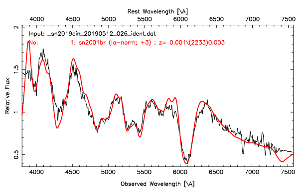

Here is my spectrum from the same night (black curve) overlaid on the best fit from SNID (red). SNID predicts a type Ia at maximum B brightness +-5 days.
The fit to a typical type Ia is excellent but like the Global SN project found in TNS, SNID also estimates a blue shift relative to the published host galaxy redshift (z = -0.003 +-0.006 compared with 0.008 for NGC5353 from NED). I understand estimating redshifts from supernova spectra is not very accurate though

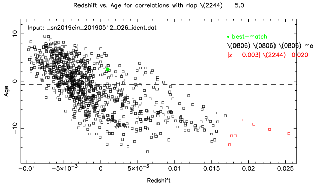

It is not easy to measure the redshift from a type Ia supernova spectrum. All you have are very broad absorption lines which are blue shifted by the velocity of the explosion. This velocity also changes with time. SNID tries to estimate the redshift and age of the supernova by matching with known supernovae spectra but the solution is not unique so the errors can be large. Attached is the age/redshift graph from SNID and the predicted most likely redshift and age for this supernova. There are also a few possible fits at 0.0078 redshift though.
There might be something peculiar about this supernova as the original classifiers suggested on TNS (an unusually high velocity of the explosion) which might be the reason for the redshift error. Also the published galaxy redshift is probably measured in the nucleus and this supernova is at the edge of the galaxy where the velocity could be different.
