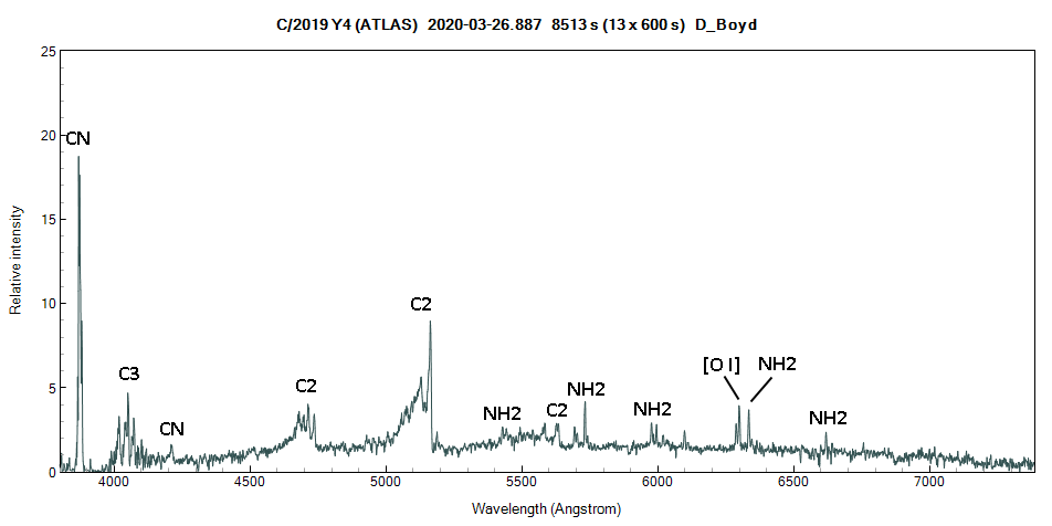

Spectrum taken on March 26 with a LISA spectrograph on a C11 scope. Total exposure 2.2 hrs guiding on the comet. Main emission features identified.
C2019 Y4 (ATLAS) 2020 March 26.png (41.28 KiB) Viewed 12036 times

Posted: Sat Mar 28, 2020 6:19 pm
Great spectra. Congratulations.
I opened a page in the database : http://www.astrosurf.com/aras/Aras_Data ... 2019Y4.htm
Bonne continuation

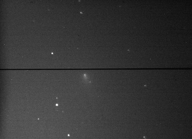

Et voici ma contribution avec un spectro LISA sur un télescope RC400 Astrosib.
Et l'image du capteur d'autoguidage ou j'ai pu autoguider sur le noyau de la comète.

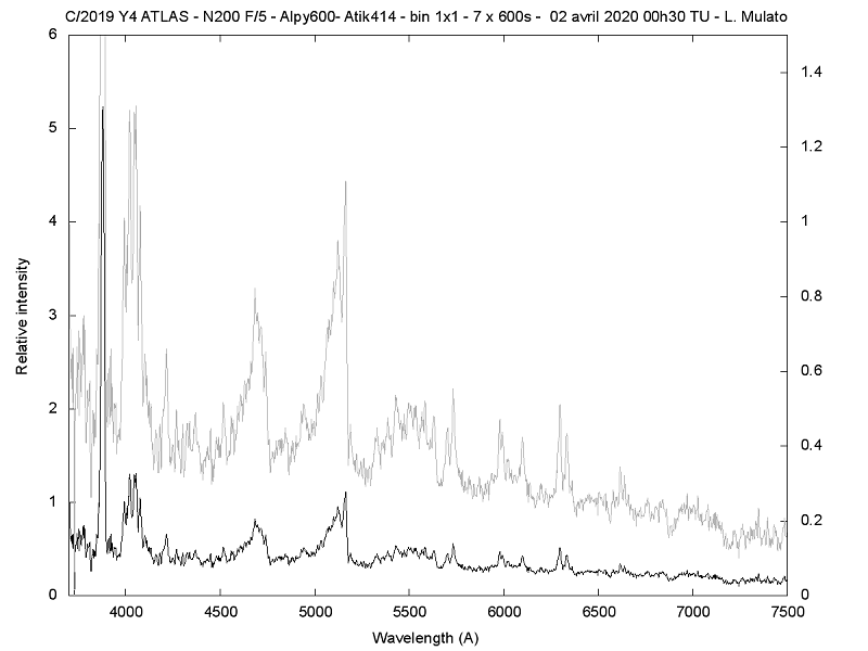

Posted: Thu Apr 02, 2020 7:24 pm
by Lionel Mulato
Jolis spectres !
Voici ma contribution.
C-2019 Y4 ATLAS.png (49.5 KiB) Viewed 11710 times
