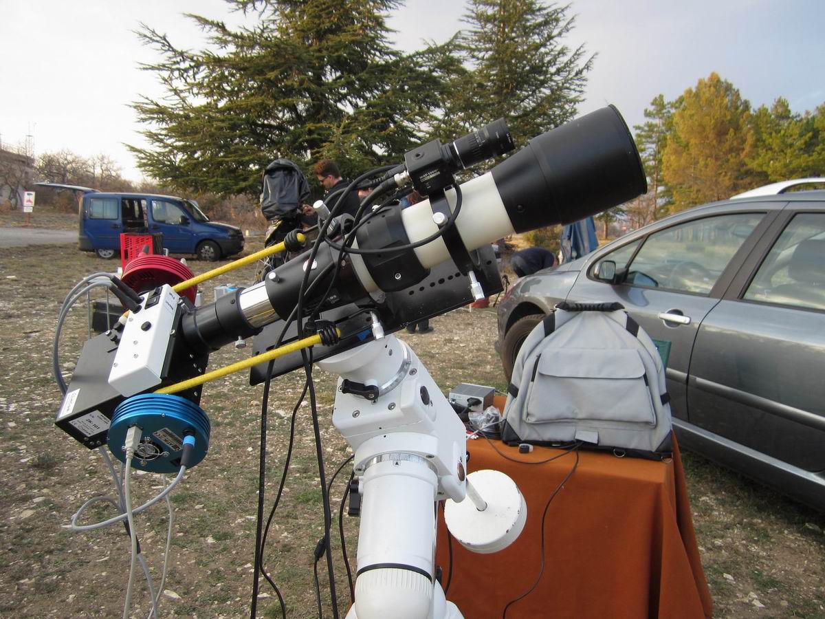

Very similar configuration when traveling: Televue 85mm on a NEQ6 Pro mount with LISA spectrograph. Here is a detailed description of the equipment & software:
* Windows 7 (64bits) computer with ASCOM 6.1 platform and AudeLA 2012.3.12 (two instances run: A1 and A2)
* Mount: NEQ6 Pro with EQ Direct cable controled through EQMOD.Telescope:
-Joystick to move the telescope manually
-Carte du Ciel 3.4.1 for GoTo & star Synchronization (pointing model)
-AudeLA "Autoguiding" module for autoguiding [instance A1]
* electronic Finder:
-75mm F/2 C-mount lens on a Watec 120N+ video camera in parallel to the Televue 85 (alignment made with the mounting ring on a fixed lamp).
-USB2 grabber to digitize the video image on the computer
-AudeLA "Telescope" module to display the image with a cross hair [instance A1]
* Televue85 Optical Tube Assembly with LISA spectrograph:
-Atik Titan guiding camera controled through Atik drivers, ASCOM drivers and then AudeLA "Autoguiding" module [instance A1]
-Atik 314L+ spectra acquisition camera controled through Atik drivers, ASCOM drivers and then AudeLA "Acquisition" module [instance A2]
NEQ6 Pro + TV85 + LISA + Atik
IMG_4277 TV85-LISA-Atik.JPG (205.16 KiB) Viewed 27102 times
I tried a single instance but it was unstable (AudeLA crash) so I switched to two instances of the same software and it seemed to work very well.

The good news is that it working very well with AudeLA 2012.03.12 version and ASCOM platform. It is very easy to Go To a target with Carte du Ciel et center the target with the electronic finder. Then standard acquisition with autoguiding during exposure.
I started this setup at OHP local astronomy (CALA) camp...
First night was a test night and I had lot of issues initially with a single AudeLA instance. I also decided to install the electronic finder which helped a lot! :-)

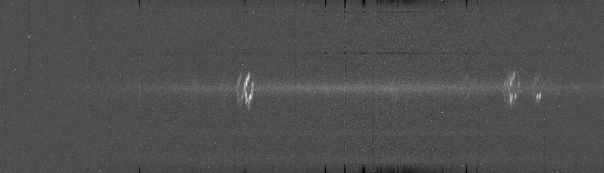

Here is the spectrum of M1:

In summary: excellent 'light' configuration when traveling with some limitation on the magnitude reached out...

Très original l'aide apporté à la crémaillaire par les Sandox !
Bon spectre de M1. Tu a du noter que centrage et guidage sont facilités par la courte
focale. C'est pourquoi je trouve cette configuration interessente pour
l'apprentissage (aui minimum). Vive les lunettes.
(comment est le chromatisme dans le bleu ?)

Le spectre est très étalé dans le bleu... un peu déçu sur le Televue sur ce coup là... :-)
