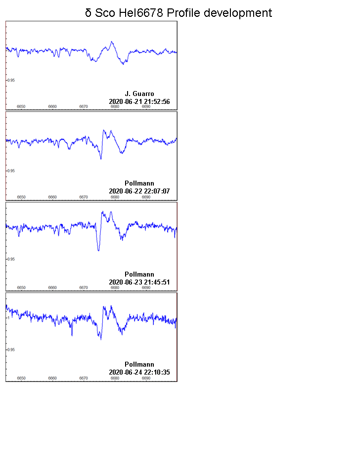

Hi Joan,
as you know, I used already your excellent HeI6678 spectrum taken with your NOU_T-Echelle (attachment). There are obviously ways with this sort of spectrographs to receive useful spectra with a very well S/N. As your result shows, simply to increase the exposure time did lead to success. An earlier statement in this forum, there is no way to reach that, seems to be disprove.
Hi Olivier,
indeed, to receive an useful HeI6678 spectrum of delta Sco (and for gamma Cas too; see: https://www.aavso.org/gam-cas-campaign-01) with an acceptable S/N is a challange, I know. In this sense your spectrum from 2020-06-24 is really not useful (compare it with the attached spectra sequence) . Also here I would like to recommend, clearly to increase the exposure time, similar to Joan.
Concerning the sense of studying the HeI6678 profile variability you should read the link at this forum:
http://www.spectro-aras.com/forum/viewt ... =14&t=2506
delsco_ 2018-2020.png (57.31 KiB) Viewed 5002 times
Ernst
