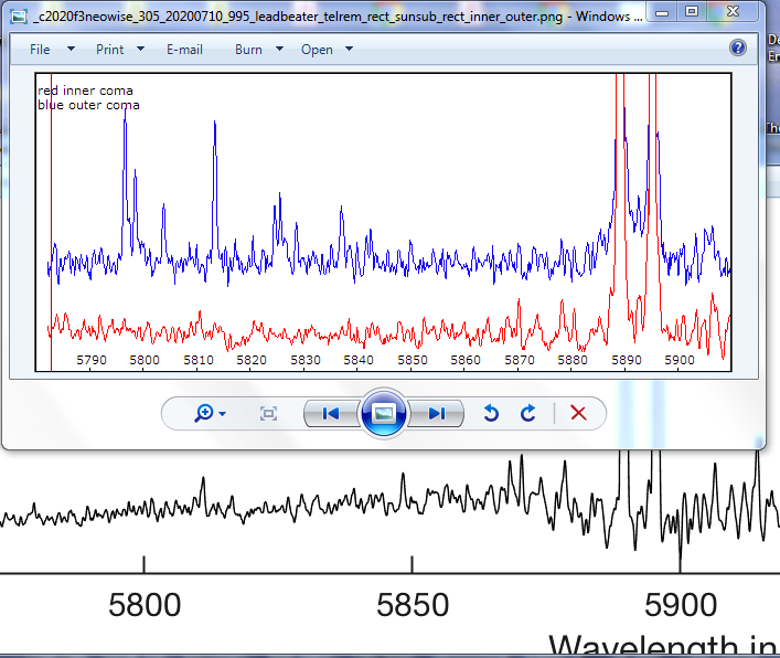

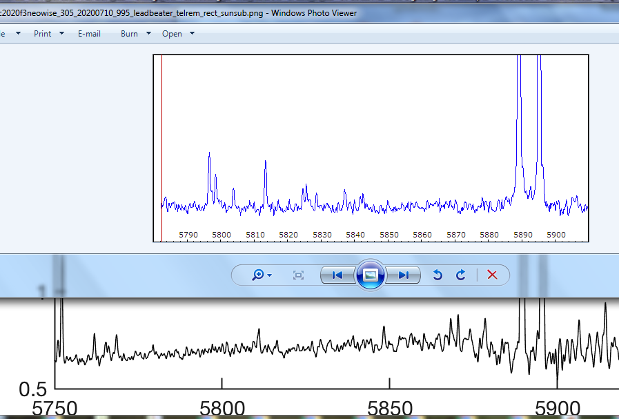

Fascinating ! The faint emission lines in the Na D region have changed completely since my spectrum at the same resolution 5 days earlier

Robin Leadbeater wrote: The faint emission lines in the Na D region have changed completely since my spectrum at the same resolution 5 days earlier
The difference is because of the different locations of the spectra within the coma. (An advantage of a slit spectrograph) These emission lines only appear in the outer coma. My spectrum of the inner coma (sun and telluric lines subtracted) matches quite well
