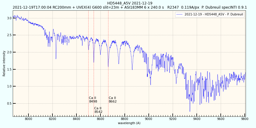

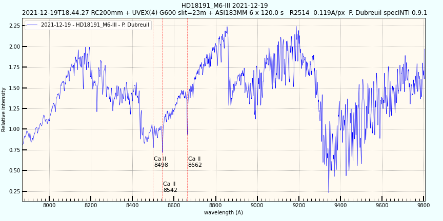

Here is a concrete example obtained with UVEX (4),slit= 23µ, grating= 600, F/D=8 the resolution power obtained is around 2500, it is lower in UV.
Spectre HD18191_M6-III 7869 to 9809.png (96.17 KiB) Viewed 8577 times
Spectre HD5448_A5V 7869 to 9809.png (82.68 KiB) Viewed 8577 times
