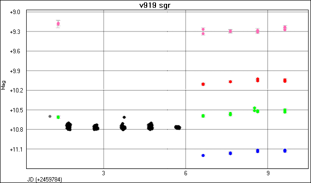

V919 Sgr in outburst
Posted: Tue Aug 02, 2022 6:48 am
https://www.astronomerstelegram.org/?read=15528
AAVSO light curve :
Re: V919 Sgr in outburst
