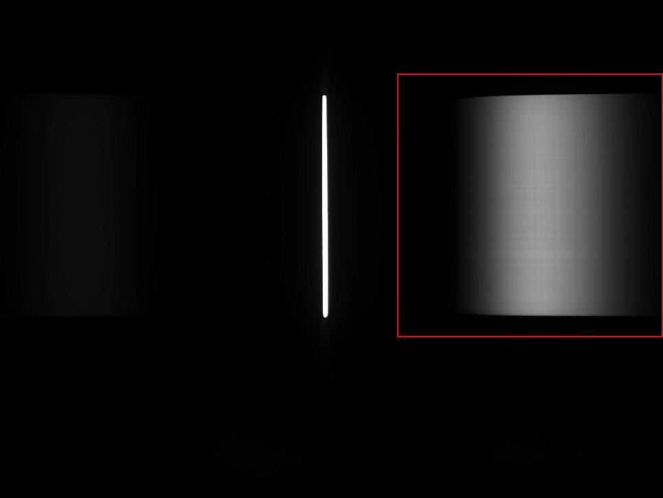

If you are using ISIS with the ALPY200, it is important to crop the images to remove the large areas of black where there is no spectrum. If you do not do this ISIS calculates the average of the flat and gets a very low value. When it then tries to scale the images it produces very high values in the black areas and very low values where the spectrum is. This severely limits the dynamic range in the spectrum, particularly for faint objects.
This is an example of the area I crop. You can crop at the image acquisition stage but I prefer to acquire full fame images and then crop using ISIS "tools", "image processing 3", "crop a directory" as it reduces the risk of cropping incorrectly and losing an important observation.

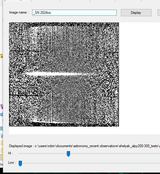

When measuring very faint objects it is important to accurately subtract the sky background which can be much brighter than the target. If using ISIS, a good check is to look at the sky subtracted image of the spectrum that ISIS produces and turn up the brightness. The sky background in the region directly above and below the spectrum should be just noise with no features in it. (If there are any features these will also appear in the target spectrum so adjust the geometric corrections and/or sky binning zones to minimise them)
(Do not worry about what appears to be the very high level of noise in the blue region. This is because the flat correction artificially increases the gain in this region where the flat lamp signal is low. Provided you average enough flats (I use 30) The flat does not significantly contribute to the noise above ~3800A in the final reduced spectrum)
It is also a good idea with faint targets to use a narrow spectrum binning zone and use the "optimal binning" function in the ISIS "General" tab to minimise sky and camera noise
