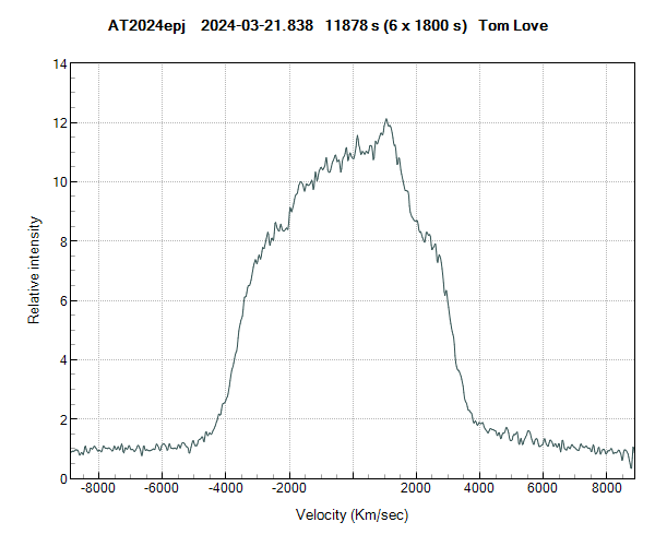

And an updated observation. This is a long (3 hour) exposure which shows a little more detail, though it's a bit noisy as we approach the near infrared. FITS files uploaded to the ARAS database as usual.
H Alpha in velocity:
at2024epj_ 20240321_838_Tom Love_HAlpha.png (21 KiB) Viewed 23644 times
Re: AT2024epj - A mag 10 transient in/near the LMC
Posted: Thu Mar 21, 2024 12:05 pm
by Olivier GARDE
Nice result Tom !!!
And this is the confirmation of our previous spectrum.
We wil try again next night with our Alpy 600 at 2SPOT in Chile....
