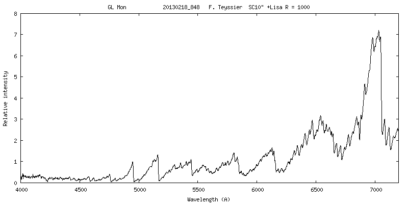

I'am in the area (Of stars, V694 Mon ... ). So I'll get a low res spectrum
GL Mon is given as a giant semi regular star by Simbad. So it may be around a maximum (with weak Ha emission)
Infortunatly there's no AAVSO data for this star (despite its brightness)
Best regards
Re: GL Mon in outburst?
Posted: Mon Feb 18, 2013 8:35 pm
A classical red giant spectrum

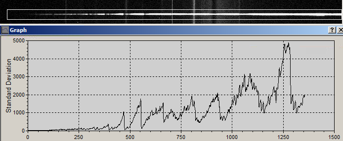

Andre - Looks like it is GL Mon and it does look bright. It is very low on my horizon but I got the attached low res spectra with a Star Analyser R~50 last night. I could not see any other bright object in the area of HD 47054 and GL Mon.
Regards Andrew
Posted: Wed Feb 20, 2013 6:30 pm
Here's the spectrum
Matches with a M7III star
Best regards
