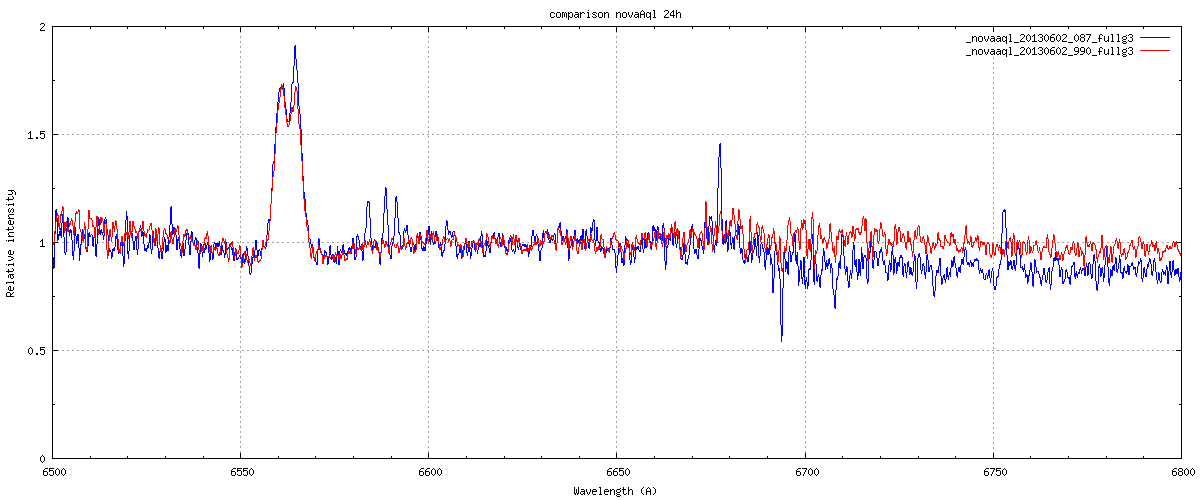

based on your alert, Thomas Eversberg and his team at IAC80 on Teide took some time from the WR campaign to observe the suspected nova with the echelle spectrograph. I had the opportunity to reduce the spectrum with ISIS. Lothar Schanne also reduced the spectrum with MIDAS. We both get the same result, shown below.
The spectrum of H-alpha seems to be consistent (I am no expert on dwarf novae) with a dwarf nova of WZ Sge type, with a double peak indicating a radial velocity of 3.6 A or +/-82 km/sec. Some other lines He 6678 and 3 additional at 6590 (Carbon?) can also be seen.

in my previous post I assigned the narrow lines to the sky background as they appear in that spectrum as well. This is not correct, as Lothar Schanne pointed out, they are caused by the memory effect of the CCD and are actually lines from the preceeding ThAr calibration, so mostly Ar lines and the He I line at 6678. The nova lines are much broader and double peaked, barely visible besides H-alpha. Detected are the He I at 5876 A and H-beta at 4861 A.

here another spectrum from IAC80 at Teide (the last one), in comparison with the spectrum from the previous night. Care was taken to avoid the memory image of the ThAr calibration, exposure time 5x600 sec (previous spectrum 3x600 sec):
spectra of nova Aql compared with previous night.
comparison novaAql 24h.png (13.37 KiB) Viewed 19060 times
Unfortunately the telescope is reserved for the WR campaign, so no more spectra wil be produced. For a study of the rotating disk structure a full time campaign would probably be necessary, which cannot be done since the WR stars and the nova cannot be observed at differnt times, rising at around the same time.
