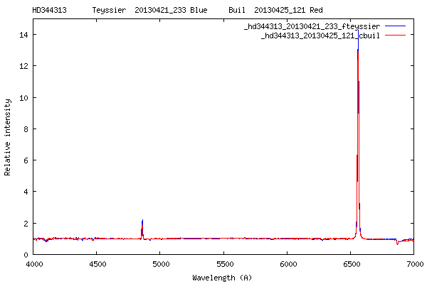

In order to find a reference star near the target I use an excel spreadsheet : http://www.astronomie-amateur.fr/Templa ... ne-xls.png
In addition, a good refrence star must have low luminosity in order to give exposure times of about 20 seconds or more ; statistically, you'll avoid the "edge effect"
Vega is definitively a very bad standart for low resolution specytroscopy
Finally, with standart procedure you describe, one can get very good results
See for instance the comparison of the some star (a Be, with great interstellar exctinction) ; Christian and I got these spectra regardless (i.e. wwithout having previously established a procedure)
