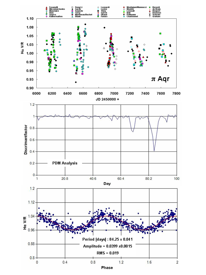

by Ernst Pollmann
Dear colleagues,
almost at the end of the visibility of the Be binary pi Aqr, here a summary of the V/R periodic behavior.
Compared with our publication in 2013 it confirms the periodicity with 84.25 days. See:
https://astrospectroscopy.de/.cm4all/up ... 8bb4&cdp=a
Thank you all for your observations and spectra which enables to draw this overview. Comments are welcome!!
