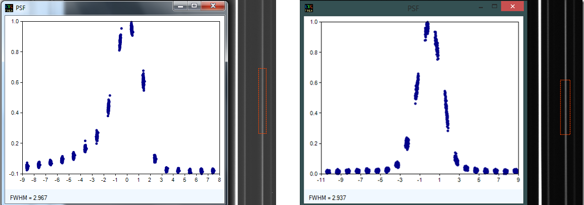

I have a question about the cross-sectional profile of neon calibration lines in my LISA spectrograph. My camera is a SX-H694 which is essentially the same as the ATIK 460. I have focused carefully to get minimum line width.
When I look at the profile of the 5945A line using the Line PSF command in ISIS, I get the profile shown (below left) which has a significant tail towards shorter wavelength. By comparison, the profile sent to me by Francois Teyssier from his LISA is very symmetrical (below right).
Neon lines.png (112.8 KiB) Viewed 8842 times
Why do I see this tail and Francois doesn't?

The 5945A neon line is more or less in the middle of the field. The length of the "tail" is the same everywhere along the length of this neon line. Towards the red end of the neon spectrum the effect is less noticeable because the FWHM of the lines is larger there. So this suggests the tail is probably of constant size in wavelength rather than dependent on position in the field.
The tail is always towards the blue end of the spectrum.
The tail was there all the time as I focused the spectrograph.
I can't really comment on the illumination angle of the neon source as that is built into the calibration unit which was on the LISA when I bought it and I haven't taken it off.
I don't think the neon lines are offset. When I get a good quality A star spectrum, I get a low rms for wavelength calibration with Balmer + neon lines which indicates to me that the neon lines are where they should be.
Any interesting question about PN spectra. The answer is yes. These lines also show the same asymmetry. So do atmospheric lines.

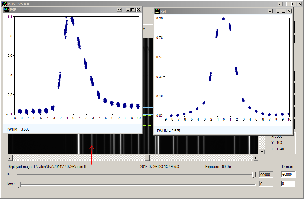

I had the same problem that you have, with my LISA, bought in 2012. In my case the asymmetrical shape was caused by some poor alignment of the 3 lenses in the camera lens barrel. The problem was that the interior diameter of the lens barrel was a few 100th of a millimeter larger than the lens diameter. On the recommendation of Francois Cochard I put some narrow strips of plastic tape in the lens barrel. This centered the lenses and eliminated the coma aberration and the lineshape became symmetrical. I tested also with the 19 micron pinhole to check the optical quality.
left image: before correction, right image: with correction
neon calibration lineshape.PNG (74.55 KiB) Viewed 8822 times
Both images were taken with the 35 micron slit and a SBIG ST8300 camera with 5.4 micron pixel size.
In case you are not sure about how to fix the lens ask Francois. He was very helpful to resolve the problem.
Before taking the lens apart check the other alignments which can be done according to he LISA manual, in particular the alignment of the collimator lens.
Hope this helps,
Martin
