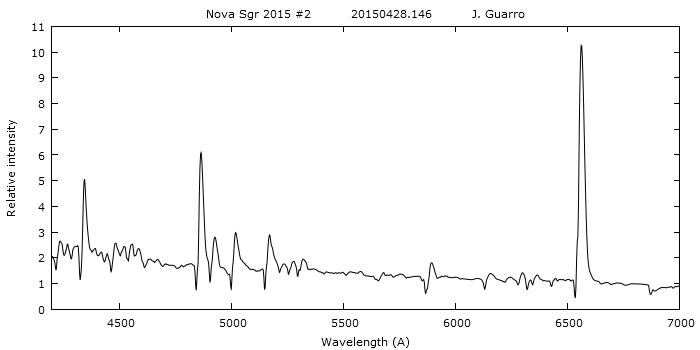

The nova reamains luminous, with strong oscillations near maximum
Joan obtained a nice spectrum, with strong P Cygni profiles
_novasgr_2015_2_20150428_146_J. Guarro.png (21.17 KiB) Viewed 18791 times

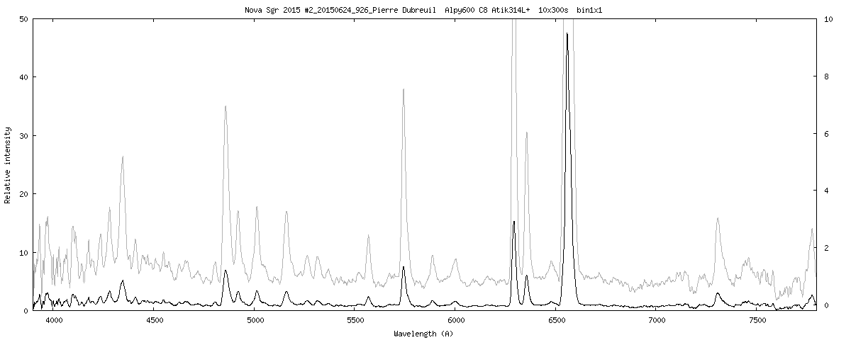

Hello everyone
Last night, in a polluted sky by the light of the Riviera I imaged the Nova which stood at less than 15 ° high off the city of Nice!.
I do not know what is its visual mag, guiding with difficult 3s poses on Nova
cordially
Nova Sgr2015 #2_20150624_926_Pierre Dubreuil.png (10.76 KiB) Viewed 18721 times

Pierre, nearly at exact same time (!!!) - from the polluted Castanet polluted sky (T200 + Alpy600) :

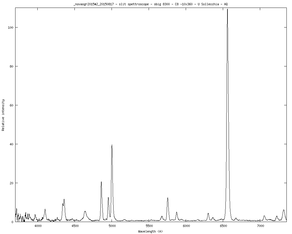

Bonsoir à tous, placez le profil spectral de la Nouvelle observé la nuit du 17/08/2015.
Profilo Nova Sgr 2015 #2.png (8.06 KiB) Viewed 18570 times
cordialement Umberto

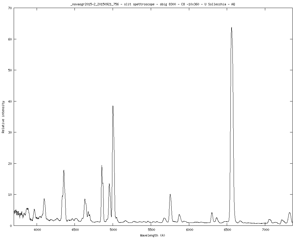

Bonsoir à tous, placer un nouveau profil de la Nouvelle observé dans la nuit du 21/09/2015.
Commence à gravir les He II 4686 .
Profilo Nova Sgr 2015 n°2.png (8.57 KiB) Viewed 18506 times
Cordialement Umberto

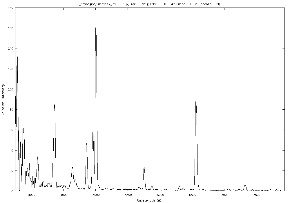

Bonsoir à tous, placer un nouveau profil de la Nouvelle observé dans le soir du du 17/11/2015.
Provilo nova sgr2.png (8.12 KiB) Viewed 18412 times
