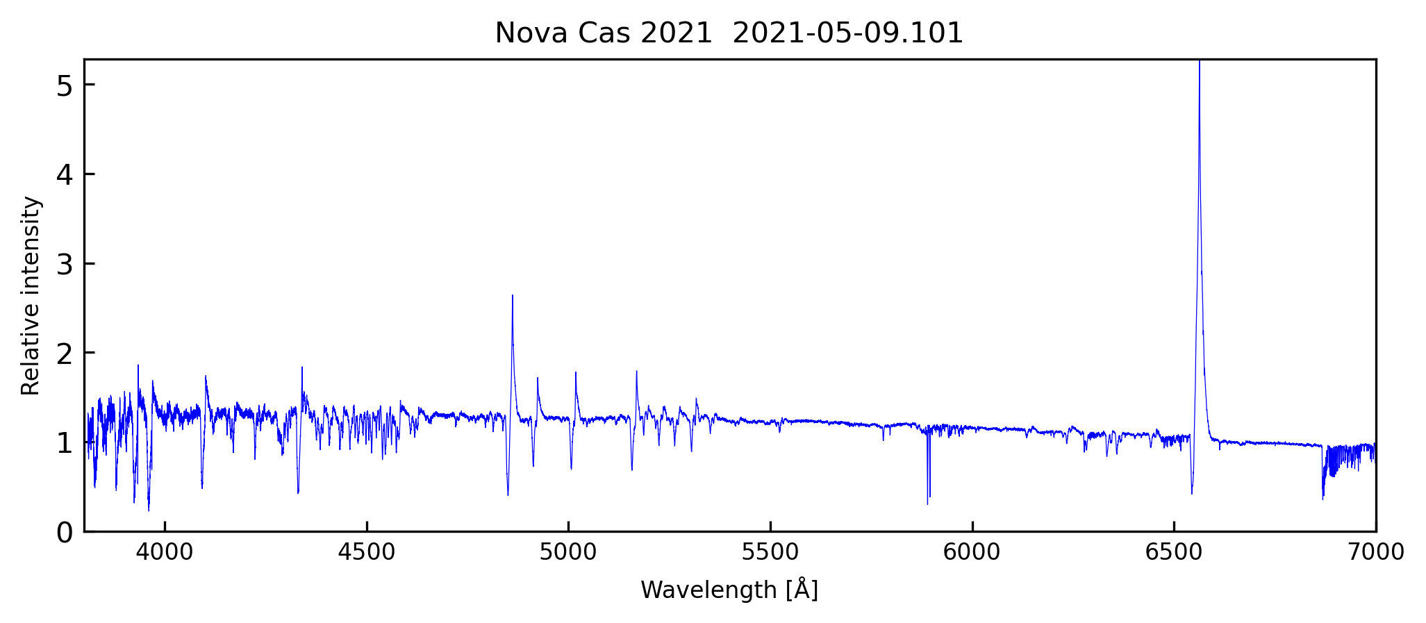

Here is my last update for the monitoring of the Nova Cas 2021.
The following spectrum was obtained the 9th of May at 1 h 10 TU (resolution of 542, JJ = 2459343.5488) with my Alpy 600 and an acquisition time of 30 min (20 x 90s) :
Clear skies to all !!
There are a lot of changes in Balmer's lines !!
