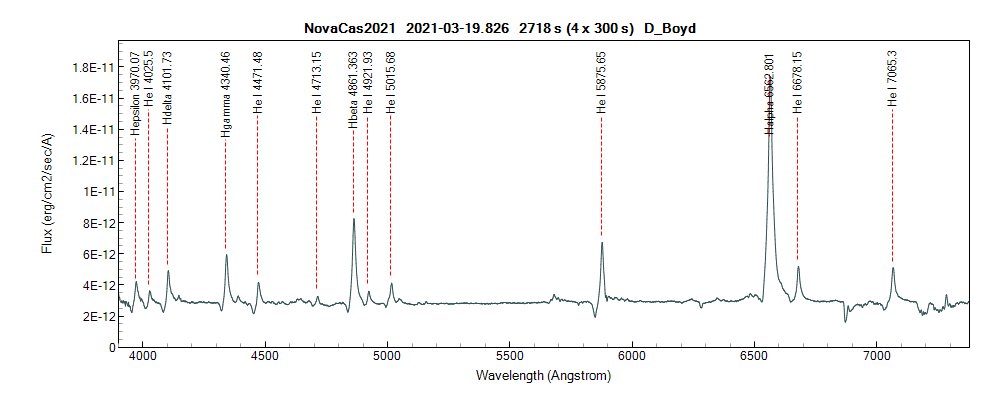

Posted: Fri Mar 19, 2021 10:54 pm
by David Boyd
This spectrum of Nova Cas 2021 was recorded with a LISA spectrograph on a C11 during a short break in generally overcast skies tonight. It shows strong emission lines of the hydrogen Balmer series and He I. There are P Cygni profiles extending to around -2500 km/s relative to the rest wavelength on all emission lines. The spectrum was calibrated in absolute flux using currently recorded B and V photometry which gave V = 7.77+-0.04 and B-V = 0.50.
Nova Cas 2021 19 Mar 21.png (31.1 KiB) Viewed 63234 times

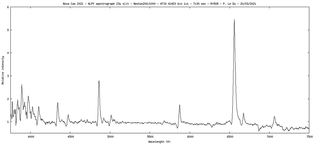

Posted: Sat Mar 20, 2021 11:26 am
by Pascal Le Du
Hello

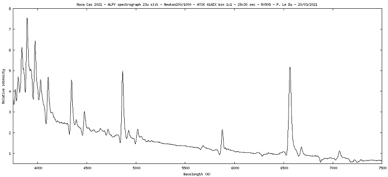

My small contribution for this very interesting Nova.
Spectrum realized from the tip of Brittany with a 200 mm newton and an Alpy600 (7x30sec).

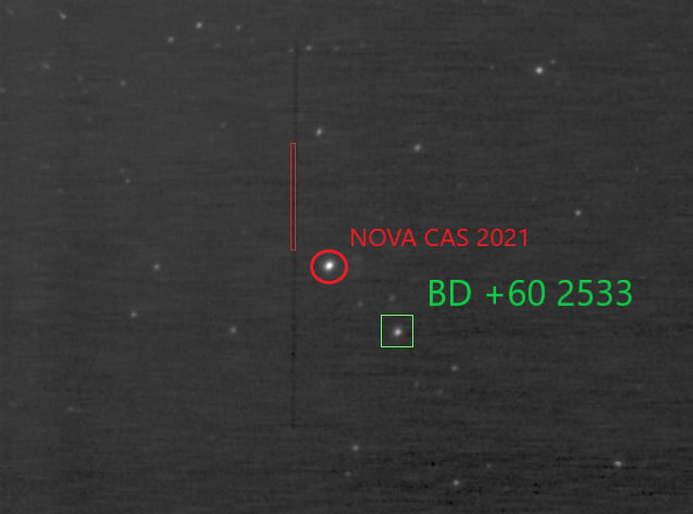

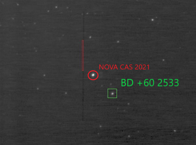

Fente sur cible
Fente sur cible

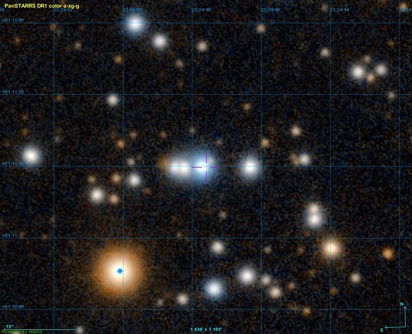

For information, it is better to make the spectrum of this nova with a vertical slit.
Indeed, as we can see on the PanSTARRS image and on my spectrum which compiles 29 exposures of 30 seconds, the stars located near the nova can pollute its spectrum.
PanSTARRS DR2
PanSTARRS DR2
NovaCas2021 29x30 sec
Pascal

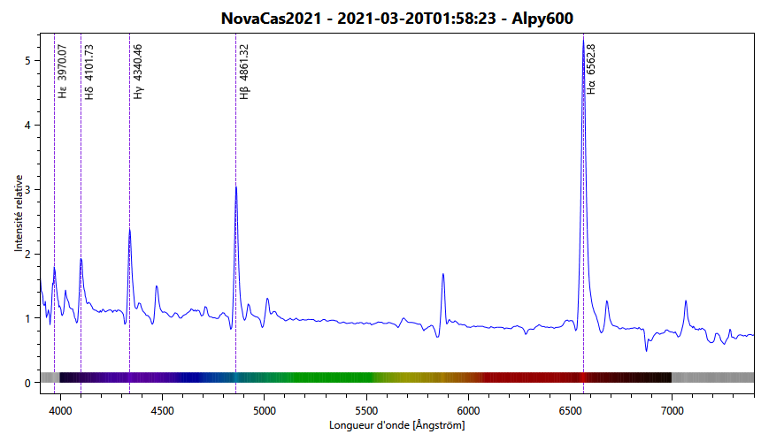

A new spectrum of NovaCas2021 with an Alpy600 last night, on C8 f/6.3 - Atik460Ex - 10 x 90s exp.
Matthieu

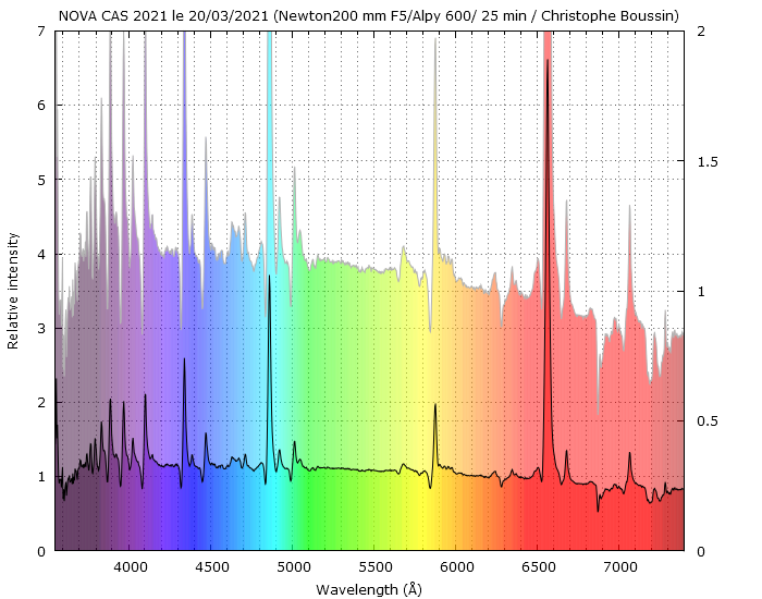

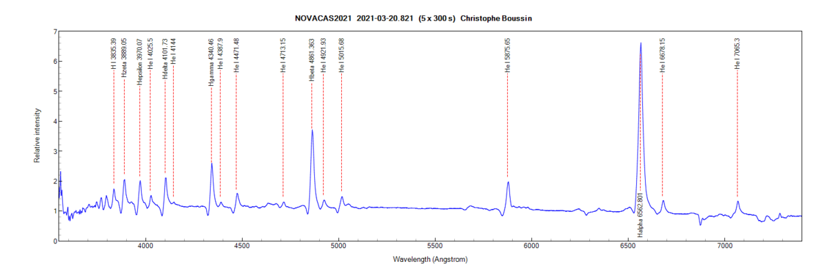

Here is my contribution to the monitoring of the nova Cas 2021.
The following spectrum was obtained the 20th of March at 19 h 42 TU with my Alpy 600 (resolution of 528, JJ = 2459294.3211) and an acquisition time of 25 min (5 x 300s) :
Guiding camera field
Champ NOVA CAS 2021.png (183.43 KiB) Viewed 63028 times
Nova Cas 2021 on March 20th, 2021
_novacas2021_20210320_821_Christophe Boussin_3550_7400.png (99.45 KiB) Viewed 63028 times
Nova Cas 2021 on March 20th, 2021 (identification of some lines from PlotSpectra)
Clear skies,
