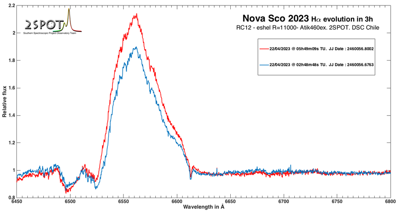

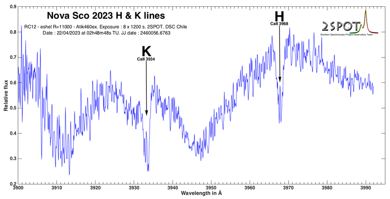

Posted: Sat Apr 22, 2023 8:09 am
by 2SPOT
Here are some provisional graphs that cover the first 2,5 hours of total exposures. We are waiting for the end of the current observations to process everything (dawn starts in 2 hours in Chile)
Le full spectrum with 8 exposures of 1200s each.
Balmer's lines graph velocity (H Alpha, H Beta, H Gamma and H Delta)
And H&K calcium lines

Posted: Sat Apr 22, 2023 12:07 pm
by 2SPOT
We process all our data (16 spectra of 1200s each) and separated in 2 groups of 8 spectra.
Here's the evolution in 3 hours
