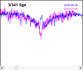

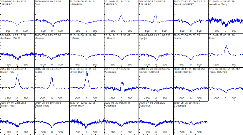

To be confirmed but seems that V341 Sge is entering again an emission phase. Look at the short time between 2 spectra, less than 2 months.
See the historical data from BeSS.
