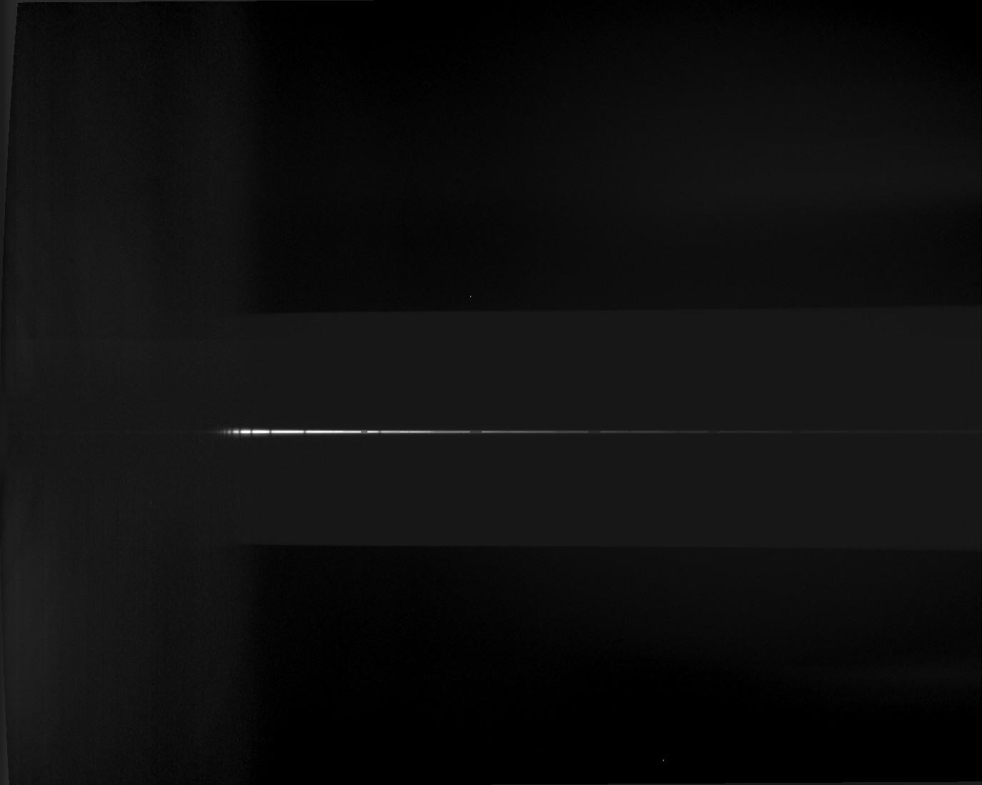

I came to do the routine processing of a reference star for an Alpy target and saw something strange in the final profile.
Thus, there were several well-defined, and equally-spaced 'notches' therein.
I finally tracked the source of this artefact to the processing of a singe sub-exposure (1 out of 5). This led to an artefact in the intermediate '@' file - see attached.
Note the 'notch' just to left of H_beta which gets repeated at regular intervals as you go towads the red end of the spectrum.
This is not present in the original data.
No other subs suffered from this.
Indeed, as a 'control experiment', I reworked the whole reduction on an alternative platform - Demetra. No problems there.
One possibility I considered was that, this was the brightest sub, and internal processing in ISIS may be sensitive to some kind of 'saturation' which is not otherwise apparent.
To test this hypothesis, I scaled the sub using the 'Multiply image by a constant' tool, but this made no change.
As a clue to what might be going on, note the weird uniform grey sector at the top left...
I also notice all files of the '@' form have negative numbers in them ....any cause for concern?

I think I may have cracked it...
Having tried many things, I finally came to try turning the cosmic ray filter off... This eradicated the artefact.
I can see that very bright portions of a spectrum can look like a cosmic ray strike. I think I am just going to stop using this filter from now on...

Hi Kevin,
Sorry I missed your post
ISIS produces intermediate (@map) files showing the pixels that have been healed by the cosmic ray filter in each image. I particularly check them on bright targets. Problems typically show up as a number of pixels in a line down the centre of the spectrum. You can then tweak the threshold to avoid this while still healing cosmic rays

Re: Strange artefact in one processed sub
So I have determined that, for 2x2 binned images, there is no setting of the cosmic ray threshold that allows eradication of cosmic rays without compromising the spectrum itslelf. I suspect that (for a well-focussed star with no DEC drift) the vertical intensity gradient across pixels is comparable with that for detecting cosmic ray events.
Things seem to work reasonably well, however, for non-binned images ('bin 1x1'). I am using a 460EX (pixels size 4.54mu)
Kevin
