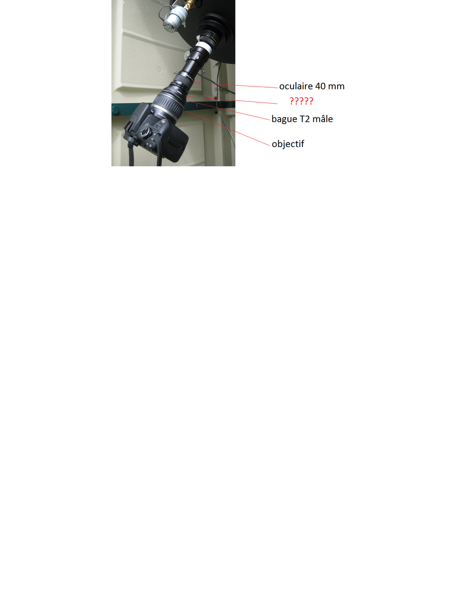

Re: réalisation spectroscope
]Hello,
Thank you Peter.
What is the name of the adapter and where to buy it ?
Thank you Peter.

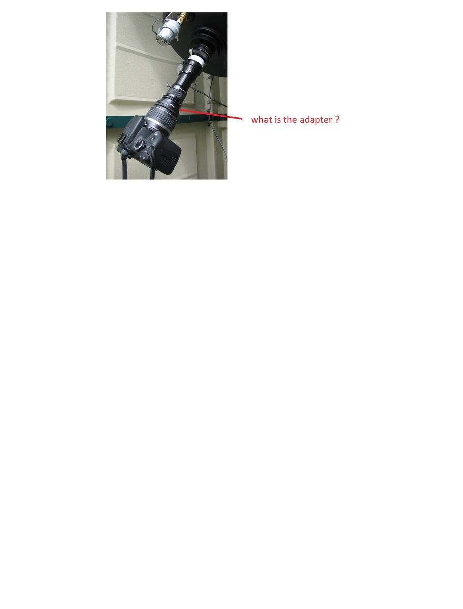

It is a 55mm to 42mm (T2) step ring. I bought it hereSebastien Berriot wrote:]
https://www.ebay.co.uk/itm/Male-55mm-to ... 0720920082
Hello Robin,
Thank you for the site.
In this configuration with APN,
what is the name of the adapter(s) after the T2 ring ?
what is the référence of the oculaire ?
where to buy the adapters and the oculaire in the site not expansive ?
The parts were from my "junk box" collection. I think this is the eyepiece
https://www.teleskop-express.de/shop/pr ... meras.html
I cannot find the exact T2/1.25 adapter but perhaps this could be used
https://astronomy-imaging-camera.com/pr ... er-adapter
To finish,
how do you install the star analyser 200 ?
It screws into the centre of the T2 male/male adapterSebastien Berriot wrote:To finish,
Hello robin,
if I summarize for this spectro it is necessary in order from the photo lens
1 ) adapteur 55m / 42 mm
2 ) adapter T2 male / male
3) in the adapter T2 male/ male there are ring T2- 1,25'' with the star analyser 200 mm
4 ) adapter T2 female/ female
5 ) eyepièce 40 mm
It is exactly ?
Sébastien
5 ) eyepièce 40 mm
It is exactly ?
Sébastien
The T2/1.25 inch adapter is not the same as mine. I just used what I had in my junk box. If you are buying all the adapters I can suggest a simpler set
Camera lens with 55mm female
55 male - T2 female
T2 male - T2 female extension tube
https://www.teleskop-express.de/shop/pr ... ength.html
T2 male with 1.25 inch hole for SA200 mounted inside the extension tube
https://www.teleskop-express.de/shop/pr ... lters.html
40mm eyepiece with T2 male
55 male - T2 female
