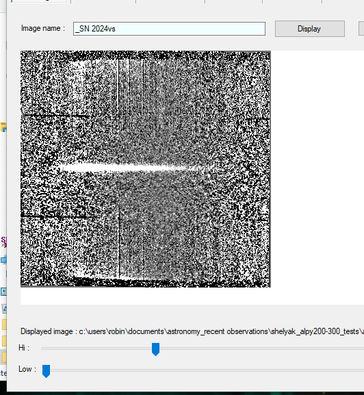

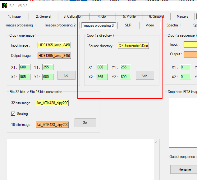

With ISIS it is also important to crop all the images before you process them so there is no large area of black. If you do not do this, the flat correction does not work correctly and you lose a lot of dynamic range which is very important on faint objects. ISIS has a good tool to do this easily
Here is an example an image (the flat) and the area I crop.

Accurate sky background subtraction is also very important for faint objects. Check the sky subtracted image that ISIS produces and turn up the brightness. The sky background near the spectrum should be just noise with no features.
