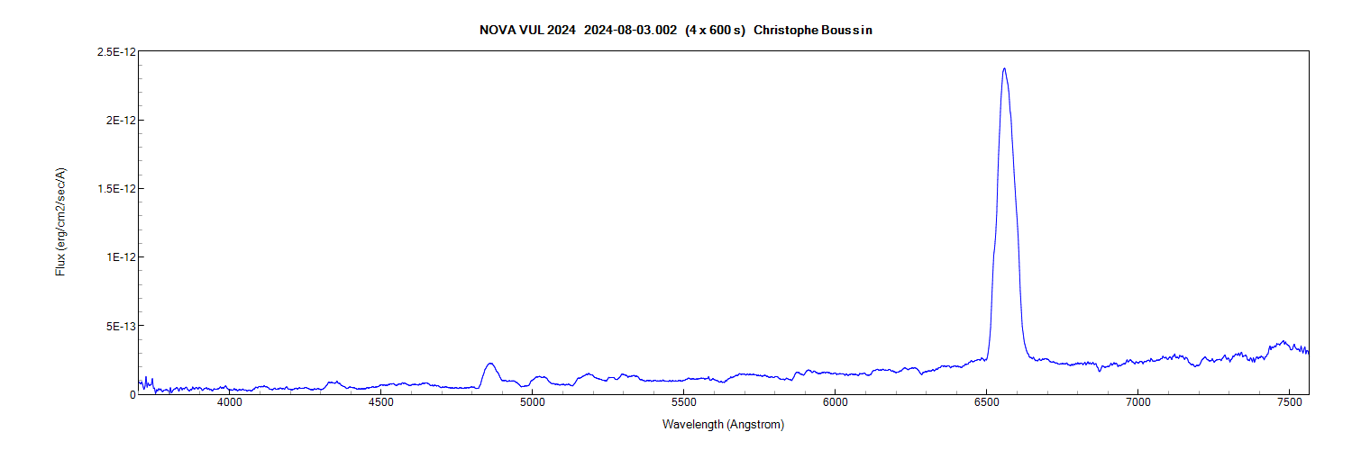

Post by Christophe Boussin »
Here is my contribution to the monitoring of Nova Vul 2024.
I obtained the following spectrum calibrated in flux (magnitude measured V = 11.12) with a spectral range from 3700 to 7565 A the 3th of August at 0 h 02 UT with my Alpy 600 (resolution of 543, JJ = 2460525.5016) and an acquisition time of 40 min (4 x 600 s) :
Nova Vul 2024 on August 3th, 2024 (flux calibrated, 3700-7565 A)
Clear skies,
David Boyd

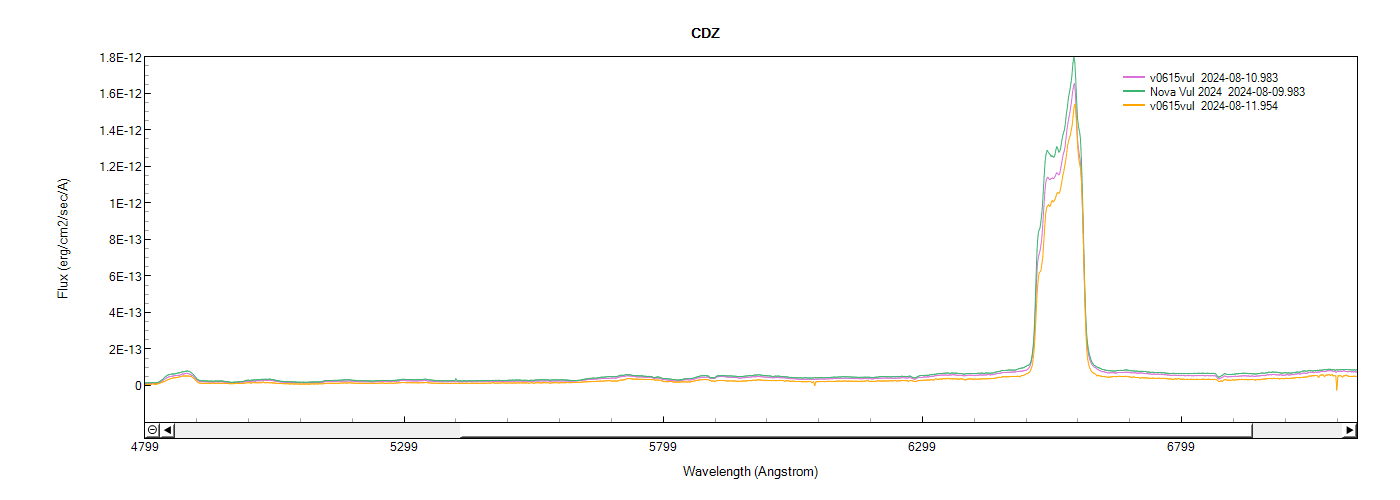

David Cejudo
Posts: 48
Joined: Mon Apr 23, 2018 9:01 pm
Re: Nova Vul 2024 July, 2024
Post by David Cejudo »
Evolution in low resolution (R≈730) during the last four days.
David Cejudo.
Observatorio El gallinero.
El berrueco, Madrid.
