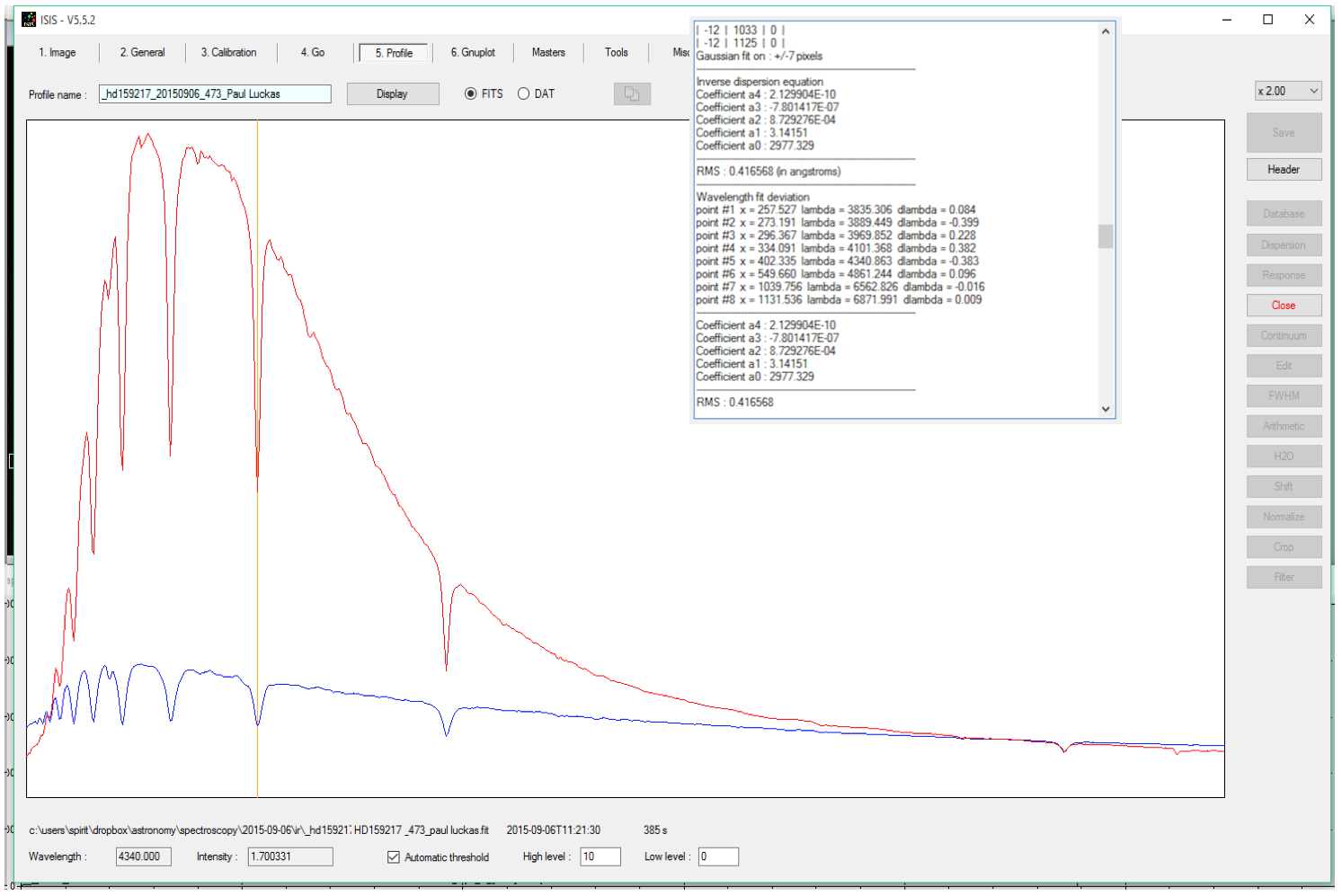

I'm experiencing some strange things working through Christian's Alpy calibration methods guide a part of commissioning a new Alpy.
Using the Balmer lines method on a nice A0V standard I get a very good result - an RMS of 0.42, and a set of Balmer lines within an angstrom or two (eye-balling) on my resulting profile. So far so good.
Then I try the pre-defined Alpy calibration module mode. Now I'm getting an RMS of 12, and resulting Balmer lines that are upwards of 15Å from where they should be. My wavelength fit deviations are all over the place, and I'm wondering what's going on here. Of note, my spectral image has quite severe fishtailing at the short end, and the corresponding neon image shows significant 'softening' at the blue end. I'm wondering if this is the cause - as during testing with the Calibration Wizard, I get an error message informing me that my "calibration error is too high" (UV on or off).

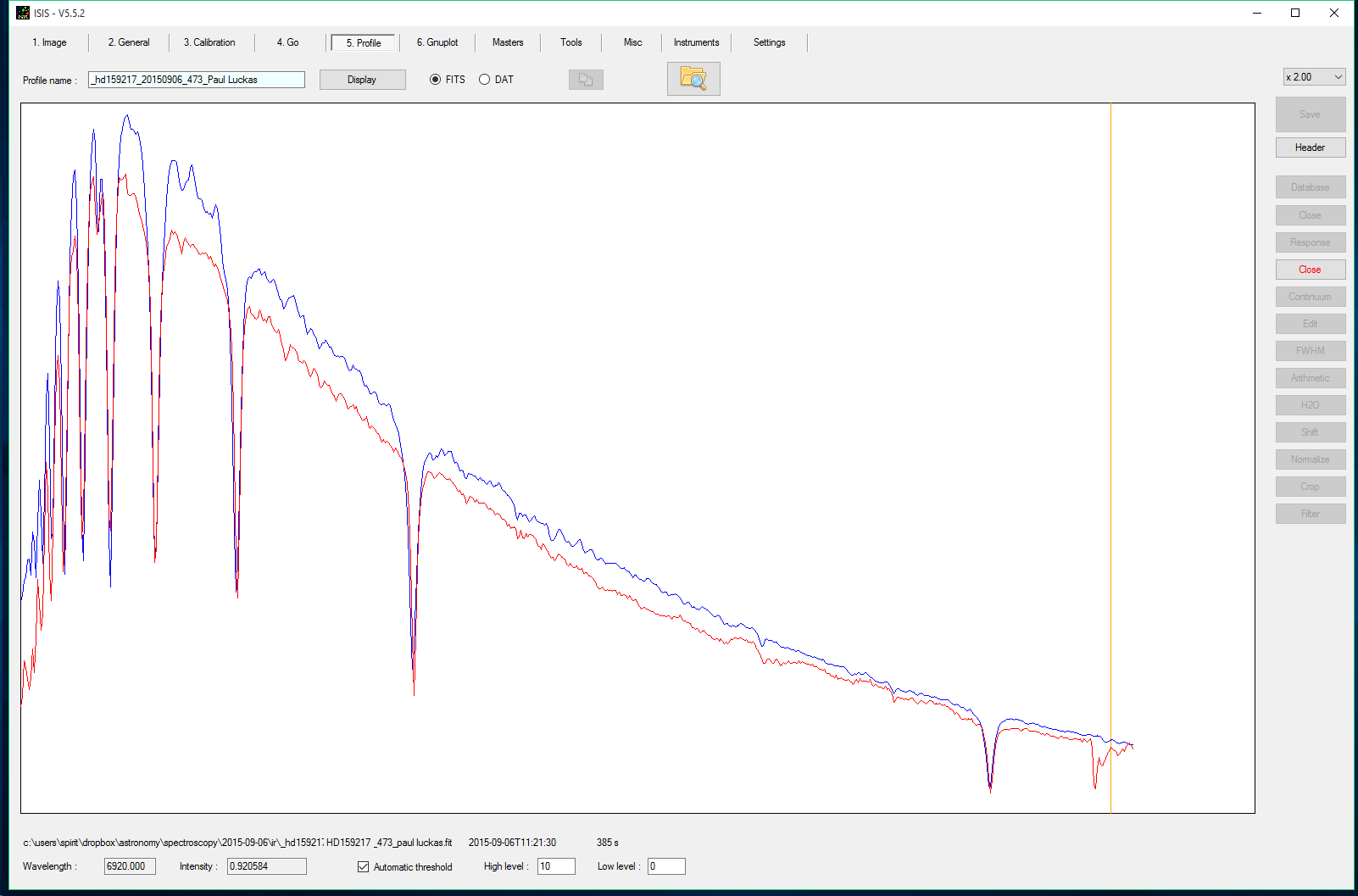

Finally, here's a result using predefined dispersion from upwards of half a dozen lines from 4200Å to 7635Å (and IR corrected this time).
