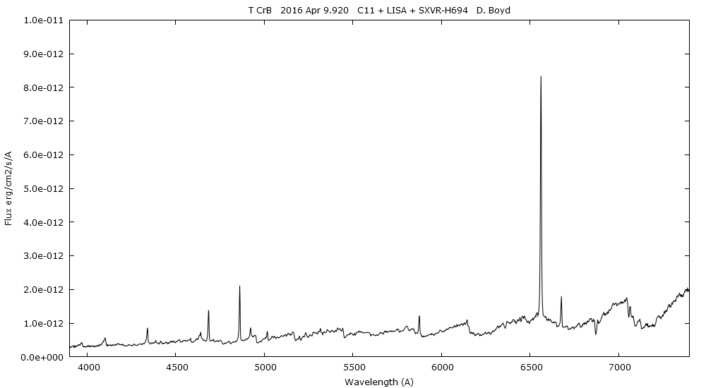

Here is a flux calibrated spectrum of T CrB taken last night, 9th April. The concurrently measured magnitudes of the star were B=10.20 and V=9.34.
The H-alpha emission line flux was 6.6 x 10-11 erg/cm2/s.
Best wishes,
- _tcrb_20160409_920_D.Boyd_flux.png (29.79 KiB) Viewed 11509 times

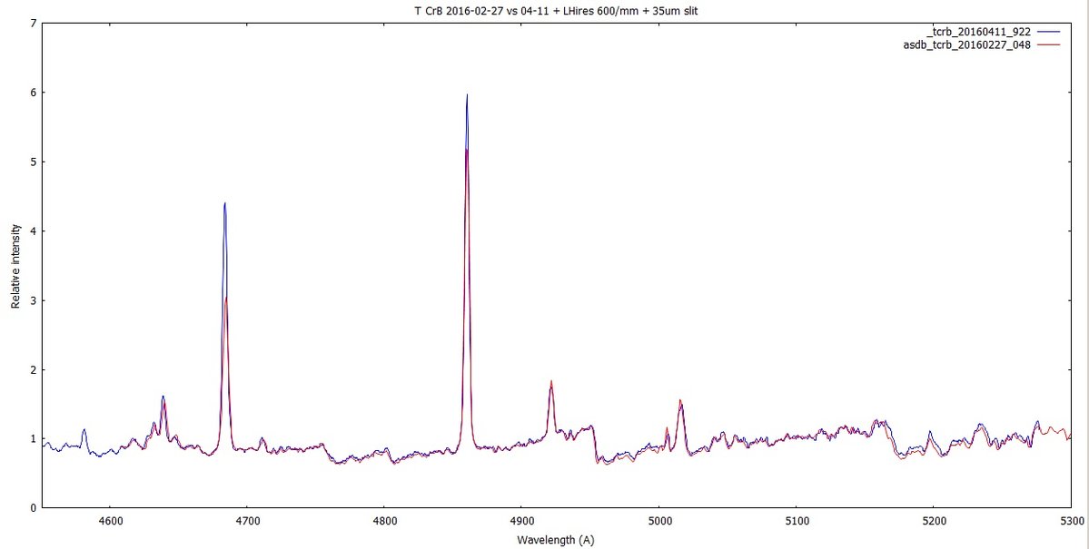

Re: T CrB High state
Posted: Tue Apr 12, 2016 8:52 pm
by Peter Somogyi
Yesterdays all night serie quick summary (29 x 10 minutes - while asleep):
- comparative spectrum
Surprisingly, HeII 4686 did not seem to change much during last night (but will process via finer methods and do analysis later).
For now just picked 1 ref.star from the middle (but taken 4 at different levels, will try to use them).

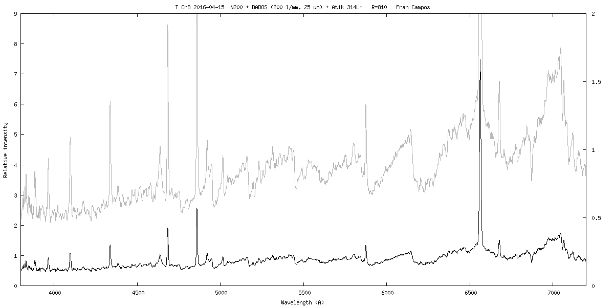

Posted: Sun Apr 17, 2016 9:28 pm
by Francisco Campos
congratulations to everybody for all these excellent spectra. Here is my modest contribution taken two nights ago with the DADOS spectrograph. For the first time the DADOS has reached a resolution of 800, not bad for a grating of 200 l/mm and a slit of 25 um. I wonder how does the DADOS will work with a more powerful grating of 900 or 1200 l/mm...
- _tcrb_20160415_952_FPC.png (13.51 KiB) Viewed 11462 times
Greetings
Fran

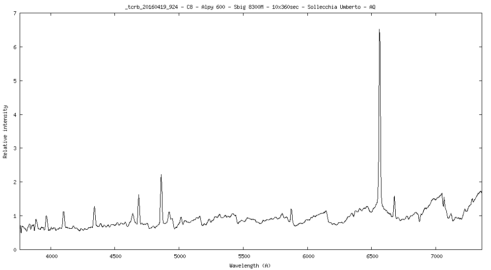

Posted: Wed Apr 20, 2016 11:01 am
by umberto sollecchia
Bonjour à tous, placez le profil de l'étoile observée hier soir.
- Profilo T Crb.png (6.68 KiB) Viewed 11434 times
Salutations Umberto

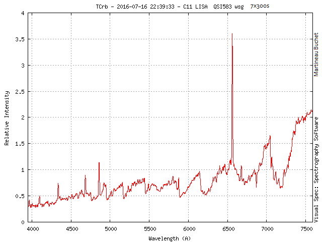

Posted: Sun Jul 24, 2016 11:13 pm
by Yolande Buchet
- _tcrb_20160716_944_martineau buchet.png (13.78 KiB) Viewed 11209 times
Hi,Bonjour,
One observation of TCrb,with C11 and Lisa, taken last week.
Cordially
Yolande,Gerard

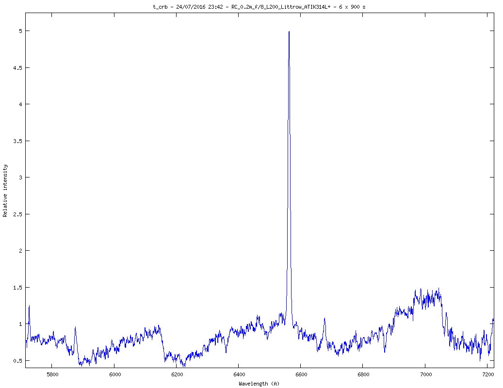

Posted: Mon Jul 25, 2016 7:17 pm
by Miguel Rodriguez
- _t_crb_20160724_988_Miguel_Rodriguez.png (10.58 KiB) Viewed 11065 times
T CrB last night. RC 8" L200, 300l/mm, R=830
Regards
Miguel
Posted: Wed Jul 27, 2016 11:19 pm
by Yolande Buchet
Hi,Bonjour,
Cordially
Yolande,Gerard

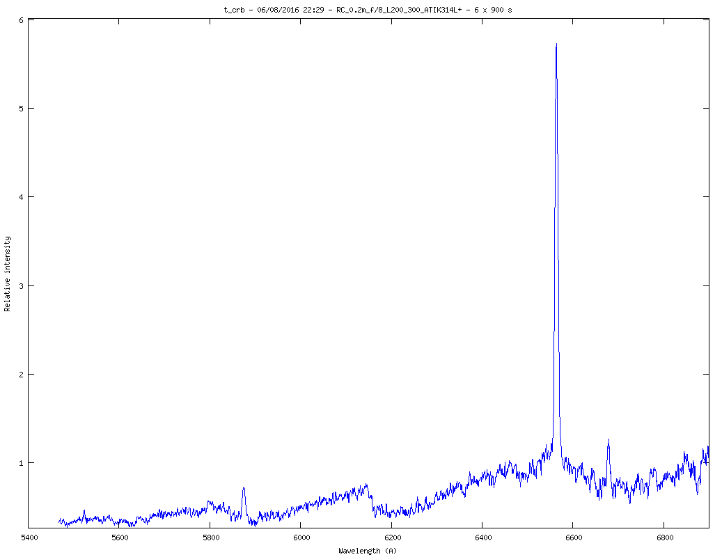

Posted: Sun Aug 07, 2016 2:40 pm
by Miguel Rodriguez
Spectrum from last night. Spectra L200, 300l/mm grating, R=728, 6x900s.
Regards
Miguel
- _t_crb_20160806_937_Miguel_Rodriguez.png (9.07 KiB) Viewed 11065 times
