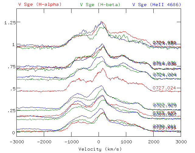

Fresh result from this Friday evening, on top of this compilation:
Blue part have the same exposures, H-alpha was scaled fully differently.
As for tellurics, would be nice to know a standard method to follow here (2 methods I'm aware: one is to have a ref.star - tried but result is contaminated by noise and H-alpha middle, other is synthethic reproduction - haven't tried yet). Sending uncalibrated (left part of H-alpha on 20160723.839 affected the most).

Thank you Francois for the formula and author names (allowed to google for article), now I've been able to create that chart:
Continuum supposed to be at 1, but scaled to 0.05 for H-alpha, 0.12 for H-beta and 0.07 for HeII 4686 on the above graphs (and continuum is added to the phase in the interval of [0..1]).
Applied shift as the absolute period.
Using all of my spectra (including a very noisy one available at blue only) + used Francois's observation on 07.14 (asdb_vsge_20160714_036), rectified continuum on it in both blue and red separately, and did a gauss filter 5 on it so now matches well by both SNR and resolution. (Unfortunately, I was able to download only this spectrum for extending my serie.)
I think the formula works well (couldn't go to sleep without trying...), was fitting the graph sizes to this:
http://iopscience.iop.org/article/10.10 ... /fulltext/
http://iopscience.iop.org/article/10.10 ... 6.fg1.html
We are somewhat different I think, but the period still seem to apply.
More spectra should be welcome I think, especially from the missing middle phases... (might require a proper scheduling)

Including now Tim's spectra (0724.004, 0727.024), revealing the middle phase:
This time made a local continuum fit around H-alpha, too.
Did set the continuum to 0-level this time, considering the skew is misleading.
I can reproduce the above diagrams in postscript when necessary (fully batched via IRAF now).
As before, was using JD-MID (without any HJD conversion - could introduce just 8.3 minute skew).
I think the color composite of the above should also be interesting:
Look at the differences of HeII 4686 and H-alpha on top and bottom (should be real, I think).
- Peter

- fixed my own asdb_vsge_20160730_011.fit JD-MID locally, forgot to handle when applied per-exposure calibration manually (visible as JD-OBS being too close to JD-MID)
- colors yet need more manual effort, can't plot colors in .ps via IRAF somehow
- used 4686, 4861.33, 6562.7 A for the zero references of velocity (couldn't find more accurate wavelength for He II 4686), maybe the He II could be tuned further
- I can publish IRAF the commands on another forum when someone is interested
EDIT: looking at differences on the color diagram H-alpha being too far from other features (also in time), but the eShel one matching all 3 features on 07.14 too well, puts up a suspect here some assumption being wrong. This needs more investigation.
