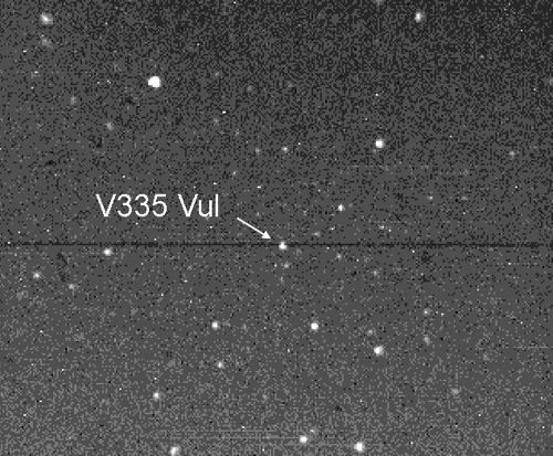

by David Boyd
Guider image of V335 Vul
V335 Vul guider image.png (198.79 KiB) Viewed 36540 times

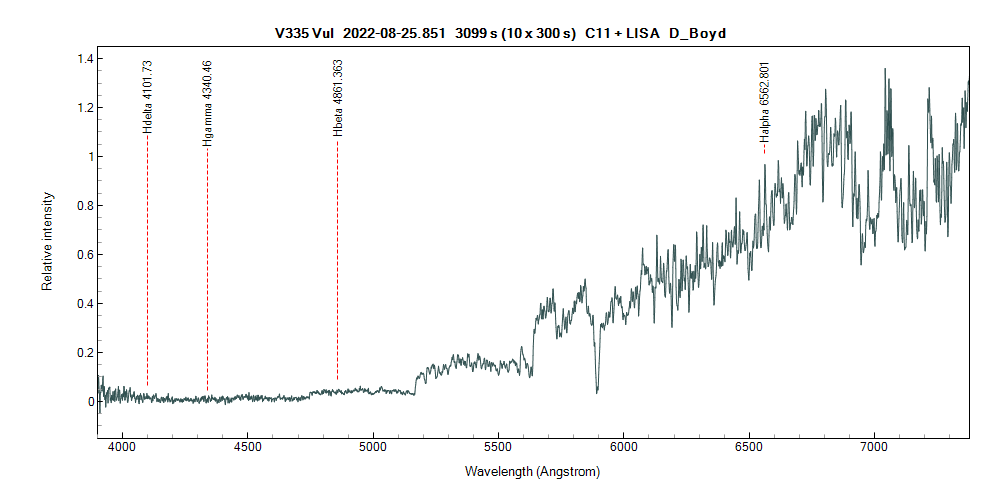

Spectrum of V335 Vul
V335 Vul.png (50.54 KiB) Viewed 36540 times
Appears to be a normal carbon star as classified in SImbad.

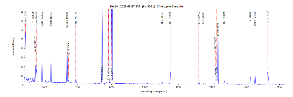

by Christophe Boussin

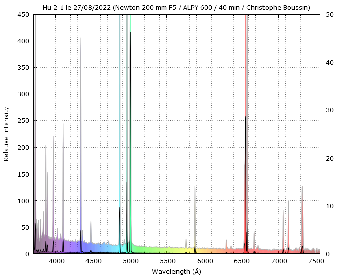

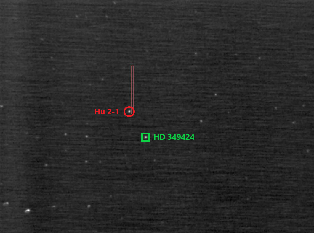

Here is my contribution to this new update of the symbiotic stars classification program.
I obtained the following spectrum of Hu 2-1 the 27th of August at 22 h 30 TU with my Alpy 600 (resolution of 535, JJ = 2459819.4379) and an acquisition time of 40 min (8 x 300s) :
Hu 2-1 on August 27th, 2022
_hu21_20220827_938_Christophe Boussin_3700_7565.png (63.47 KiB) Viewed 36455 times

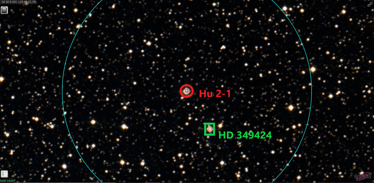

Guiding field
Guiding field
CHAMP Hu 2_1_legende.png (529.12 KiB) Viewed 36455 times
Image of the field (Aladin)
Hu 2-1 is identified as a planetary nebula in the Simbad database.
The suggested identification of the lines below seems to confirm this.
Hu 2-1 on August 27th, 2022 (identification from PlotSpectra)
Hu 2-1 on August 27th, 2022 (zoom)

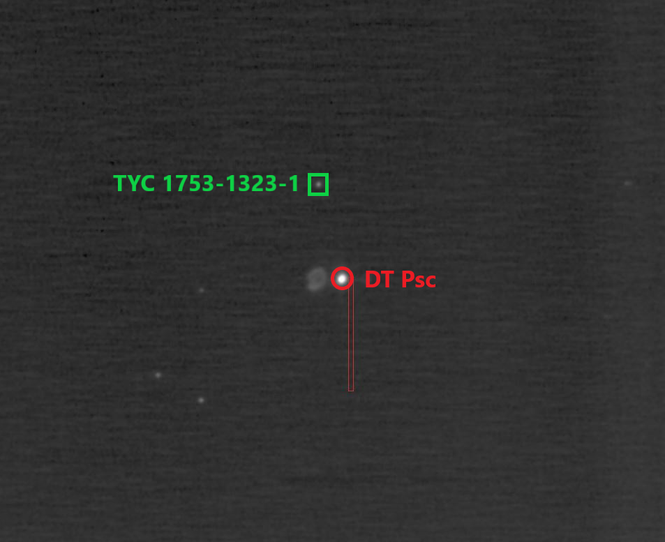

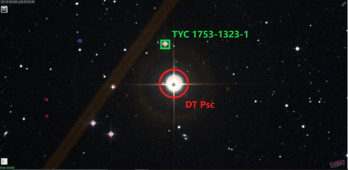

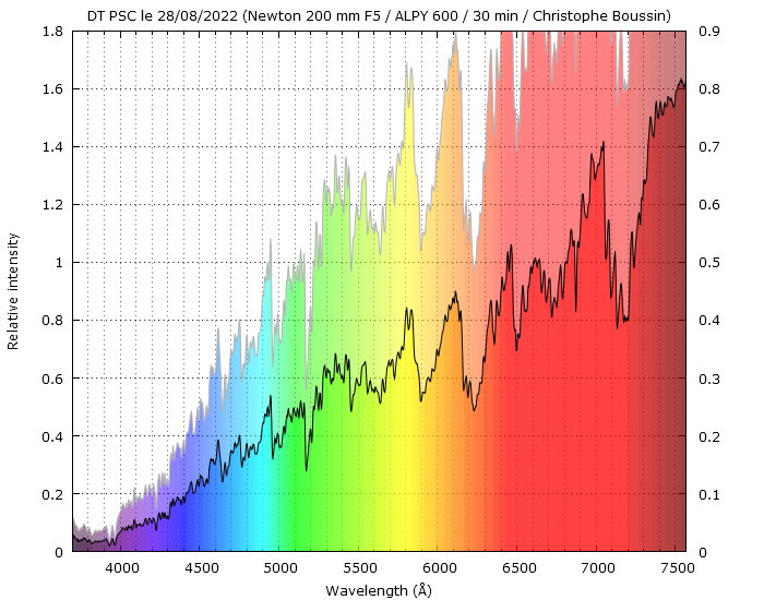

Here is my new contribution to this classification program with DT Psc, a very bright target, which is identified as a symbiotic star in the Simbad database.
I obtained the following spectrum of DT Psc the 28th of August at 0 h 56 TU with my Alpy 600 (resolution of 541, JJ = 2459819.539) and an acquisition time of 30 min (15 x 120s) :
DT Psc on August 28th, 2022
_dt_psc_20220828_039_Christophe Boussin_3700_7565.png (102.5 KiB) Viewed 36389 times
Guiding field

CHAMP DT_PSC_legende.png (381.07 KiB) Viewed 36389 times
DT Psc on August 28th, 2022 (identification from PlotSpectra)
No balmer lines are visible in emission in the spectrum.
Clear skies,
