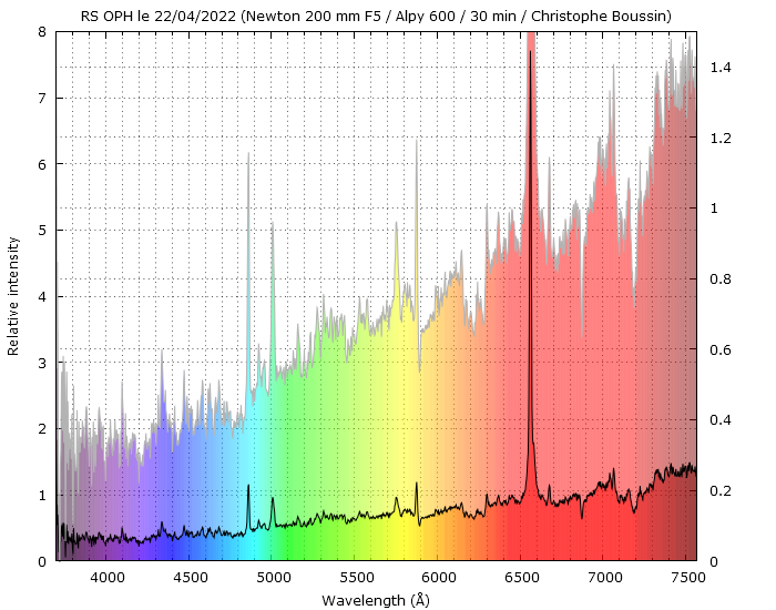

The first one, the 22th of April at 3 h 10 TU (resolution of 521, JJ = 2459691.6316) and an acquisition time of 30 min s (3 x 600 s) :

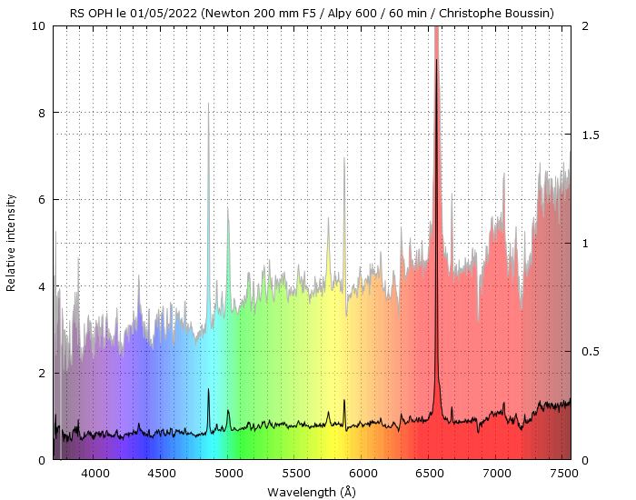

The second one, the 1st of May at 1 h 50 TU (resolution of 529, JJ = 2459700.5766) and an acquisition time of 60 min s (6 x 600 s) :

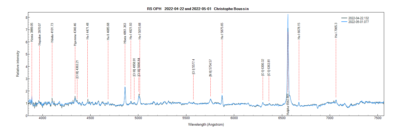

In the graph below, the spectra have been normalized to the continuum.
We can note that the relative intensity of the HeII 4686 A line is very low compared to that of the Hbeta line.

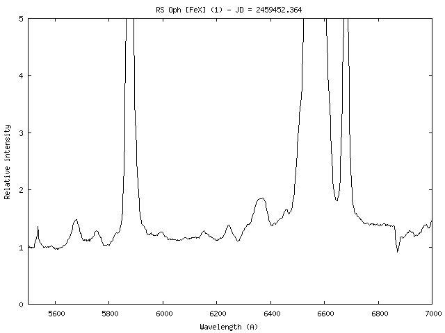

You can find a comparison of the 2006 and 2021 outbursts and a discussion on the evolution of the [Fe X] line at 6375 A (paragraph 6.3 for example and figure 14).

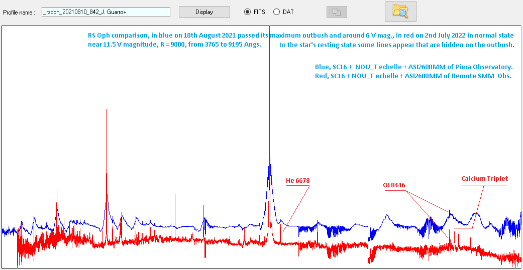

RS Oph always speaks things if you know how to read them..
Joan Guarro.
Joan Guarro.
- RS Oph Comparison.png (29.96 KiB) Viewed 24179 times
