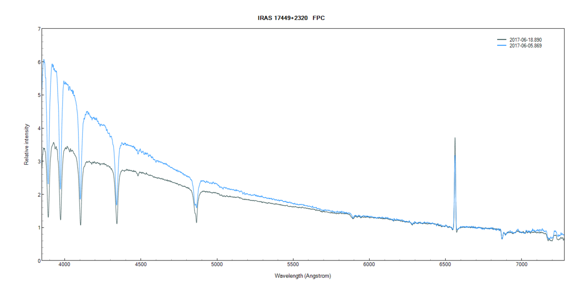

Evolution of this star since 7 days
H Alpha
H Beta
H Gamma

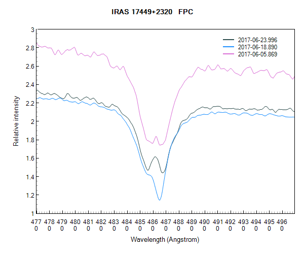

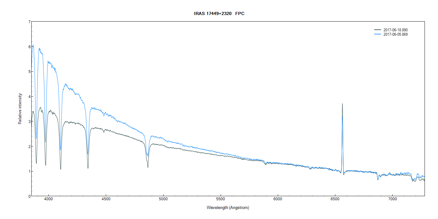

Good explanations, François, a bit hard to understand but always interesting.
Here is a comparison between two nights. Even at low resolution it is clearly noticeable the changing profile of the H-beta band. But I'm worried about the striking difference between both profiles in the blue wavelengts, while in red wavelengs the match is almost perfect. The comparison star (HD 157728, A7 V) is the same, also the spectrograph and CCD. Te telescopes used are different: newton with Barlow lens the first one, and a RC the second.
Any idea? Are these differences real? Maybe a bit of B-band photometry could give a clue...
Greetings
Fran

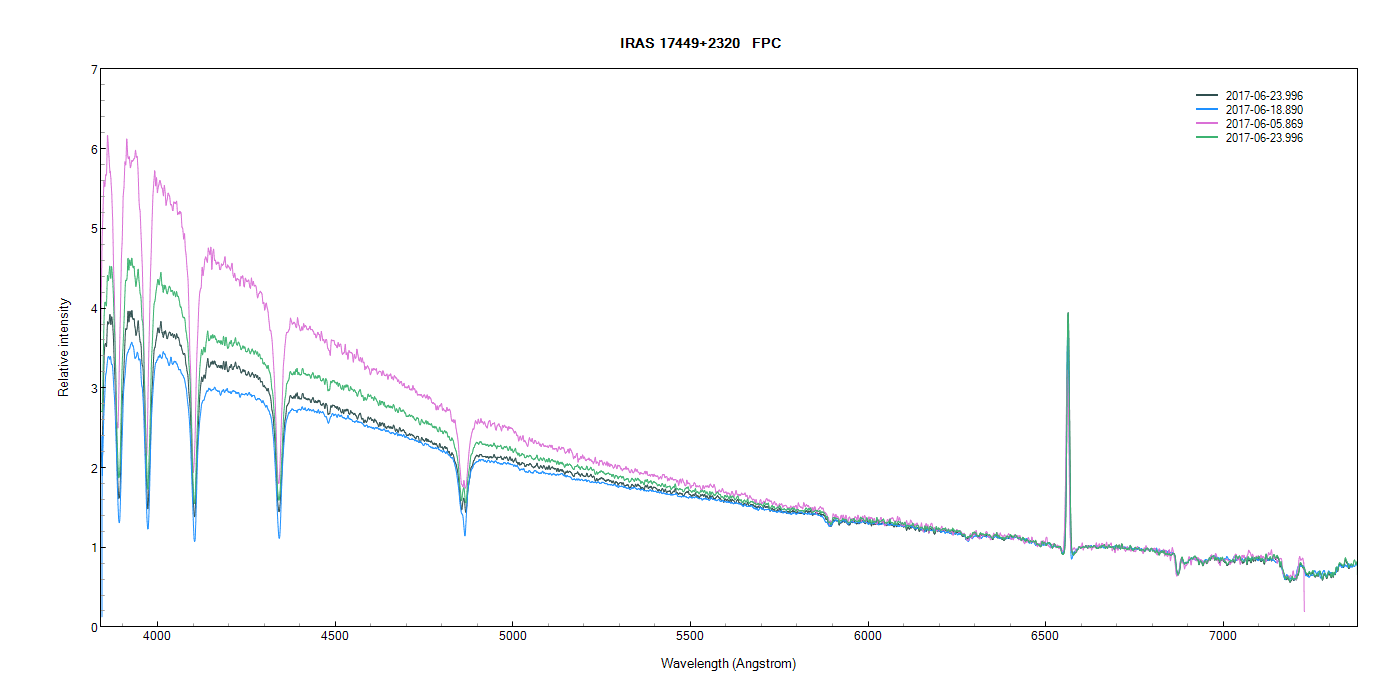

I'm quite worried about this issue. The last night, by a suggest of Joan Guarro, I took another spectrum but with two comparison stars: HD 157728 (A7 V, the star I use regularly, green spectrum) and pi Ser (HD 143894, A3 V, dark spectrum). The spectra obtained are a bit different, as yo can see here.
All spectra are, of couse, flat-field corrected, average of 20 flats exposed at 2/3 of the full histogram. But of course, at short wavelengths the response is lower.
I have been comparing spectra of T CrB processed with Pi Ser and they match almost perfectly in all wavelengths, so I don't really understant what's happening.
By the way, interesting the behavior of the H-beta band, changing every few nights.
iras17449+2320_ 20170623_996_FPC Hbeta.png (25.41 KiB) Viewed 9415 times
Greetings
Fran
Posts: 1565
Re: B[e] star IRAS 17449+2320: call for observations
Hello Fran,
This is atmopheric correction
Such variations of the continuum are not expected for that star
More, important variations would produce large variation of the luminosity; this not the case.
Nice variations of the lines!
