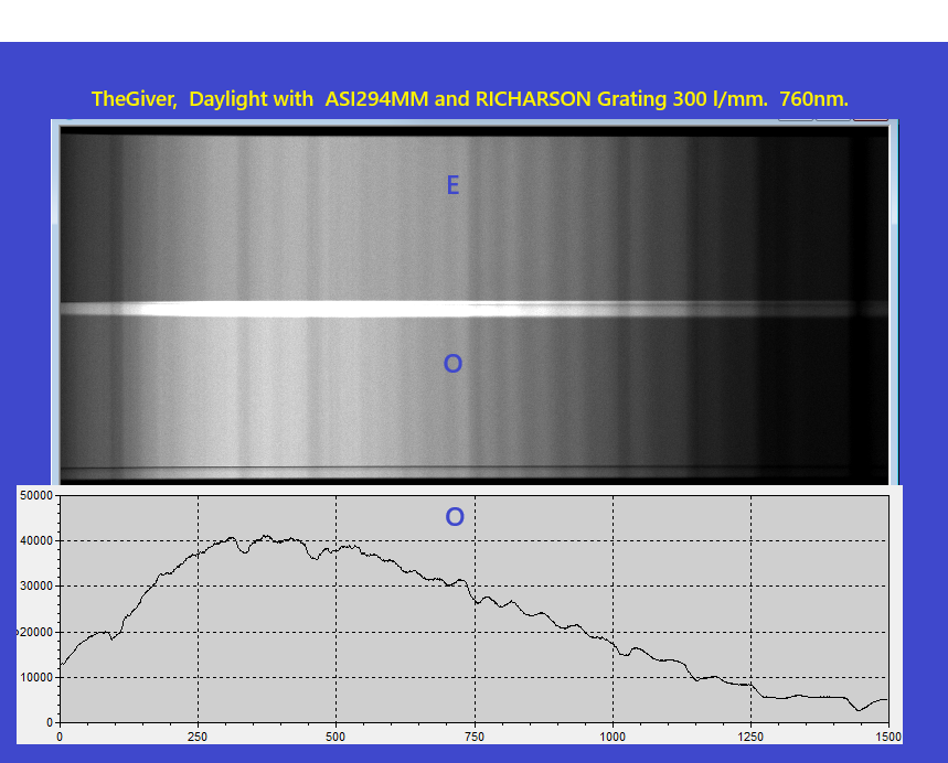

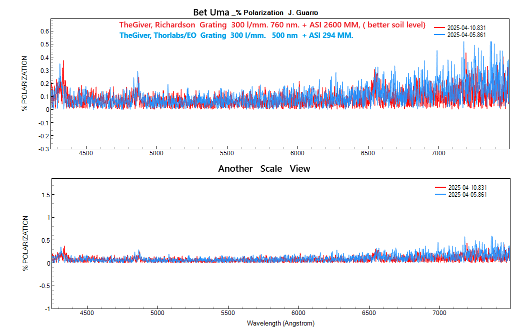

Re: POLARIMETER DEVICE PROJECT

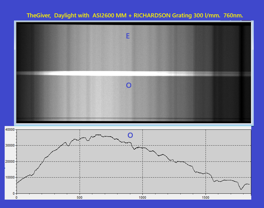

We are in the tuning stage of The Giver, fortunately, Martin Dubs gave me some suggestions and tips about TheGiver improvement.
Follow them, I can show their results here. in some steps.
Cheers, J. Guarro.
Cheers, J. Guarro.
- AIS294MM day light grapfics.png (248.25 KiB) Viewed 77272 times
- AIS2600MM day light grapfics.png (253.26 KiB) Viewed 77272 times
- betuma_%polarization_COMPARISON views_831_J. Guarro.png (157.23 KiB) Viewed 77272 times

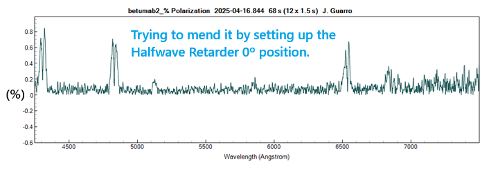

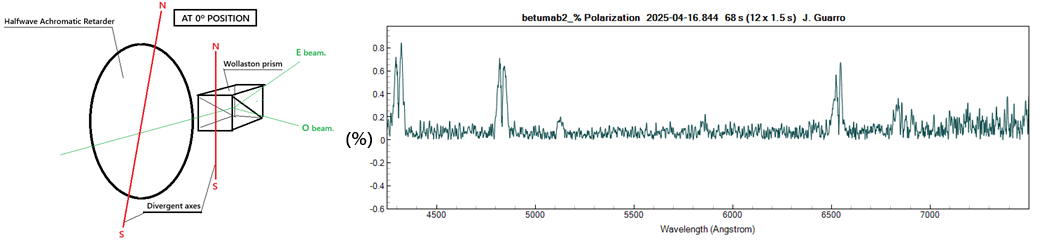

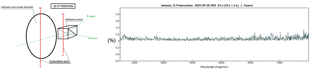

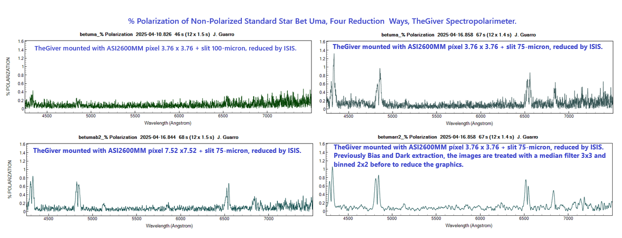

- Posts: 731
Fortunately, I have the luck of counting with the help and teaching of Martin Dubs.
So he corrected me about other erroneous interpretations about the "emission" lines in
some Bet Uma graphics and gave me the solution.
The correct way is that all were the result of a divergent position of the halfwave plate
and the Wollaston prism ones as you can see in these images.
Slowly I became more aware of how TheGiver works.
Cheers, J. Guarro.
Cheers, J. Guarro.
- THEGIVER WITH GUIDE RODS 5.png (73.73 KiB) Viewed 76668 times
- THEGIVER WITH GUIDE RODS 6.png (53.92 KiB) Viewed 76668 times

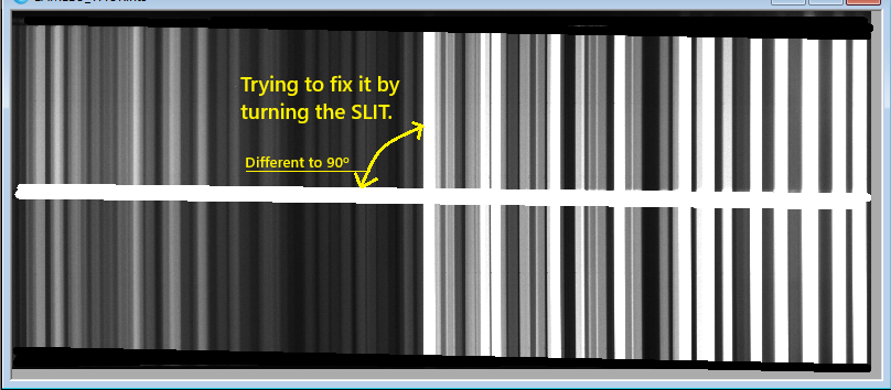

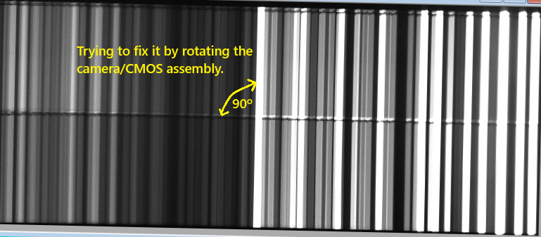

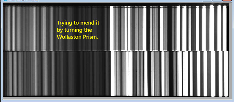

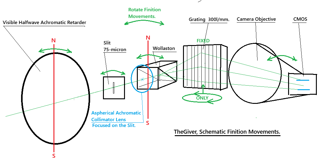

- Posts: 731
One finds the most exact point during the optical collimation job of any optical device, the success depends
sometimes on the experience, knowledge, and also of the quantity of components that one has faced.
TheGiver isn't different as you can see here the components that come into play, I believe that I tested and checked
all the possibilities, in addition, it has had a training and learning time for me.
It seems impossible that the light would allow herself to be manipulated in such a "perverse" way.
Then, after some holiday days, TheGiver observation time is coming, if the weather improves on this corner
of the Mediterranean Sea.
Cheers, J. Guarro.
Cheers, J. Guarro.

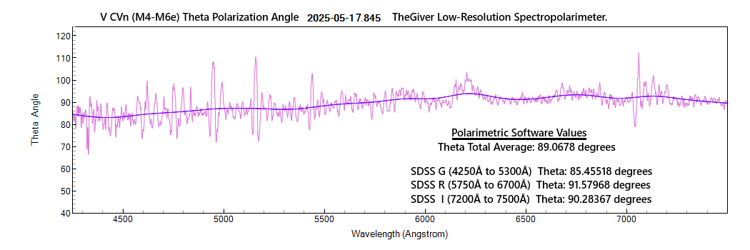

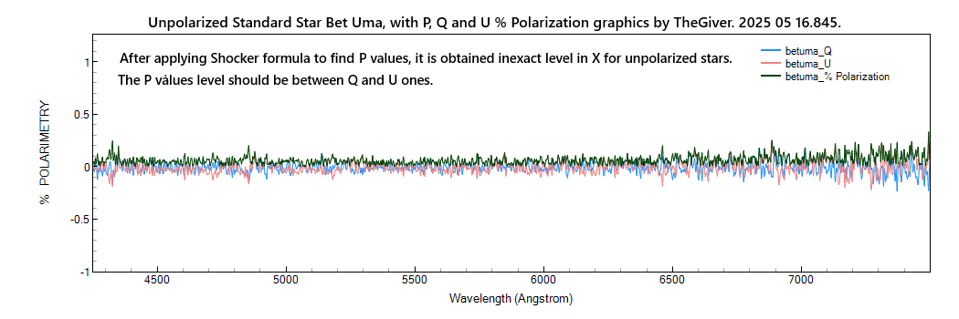

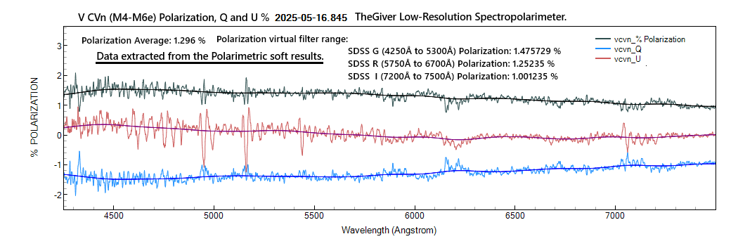

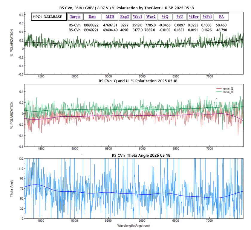

- Posts: 731

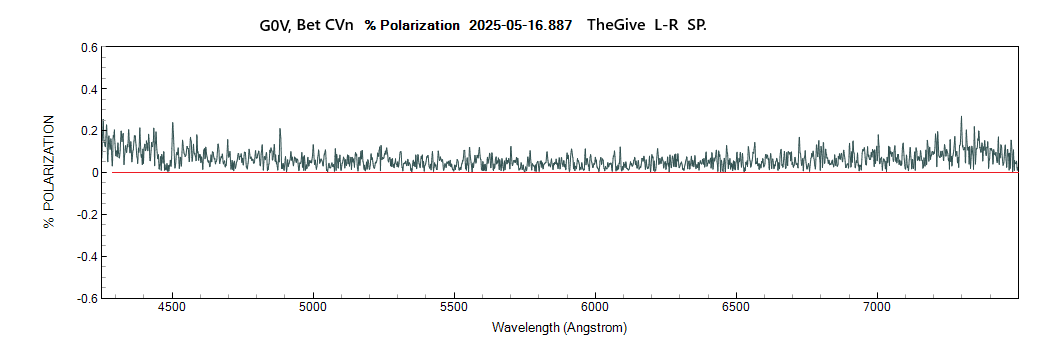

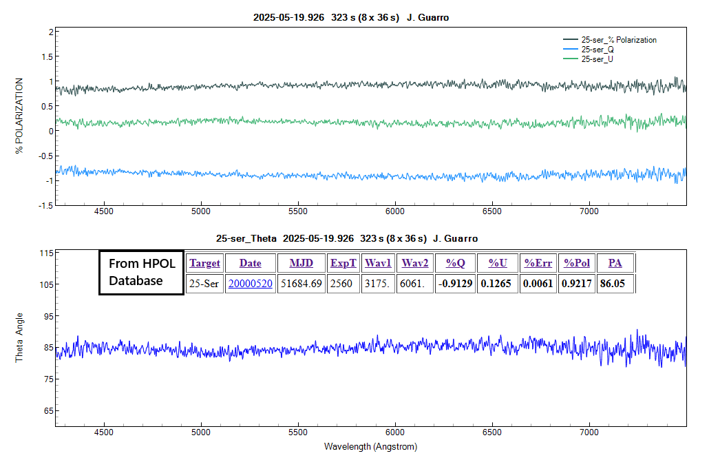

Eventually, TheGiver spectropolarimeter is well collimated and ready for observation now.
The results are extracted first by ISIS to obtain the spectra of every 22.5º step position.
The second step is by POLARIMETRIC, to obtain the polarization % and Theta angle.
Only lack to solve a little problem with the depicts of non-polarized stars. We don't have any
problems with polarized stars in this way, you can see the next graphics.
Best regards, Joan.
Best regards, Joan.
- betcvn_%polarization_20250516_887_J. Guarro.png (48.18 KiB) Viewed 73557 times
- betuma_P+Q+U_20250516_845_J. Guarro.png (79.6 KiB) Viewed 73557 times
- vcvn_%polarization_20250516_845_J. Guarro.png (111.78 KiB) Viewed 73557 times
- vcvn_theta_20250516_845_J. Guarro.png (71.48 KiB) Viewed 73557 times
- rscvn_composition2_20250516_845_J. Guarro.png (312.82 KiB) Viewed 73557 times
- 25-ser_%polarization_20250519_926_J. Guarro.png (125.68 KiB) Viewed 73557 times

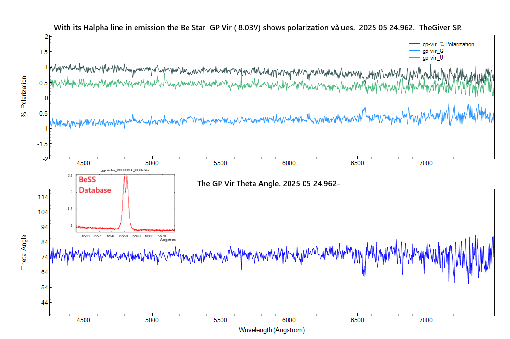

- Posts: 731

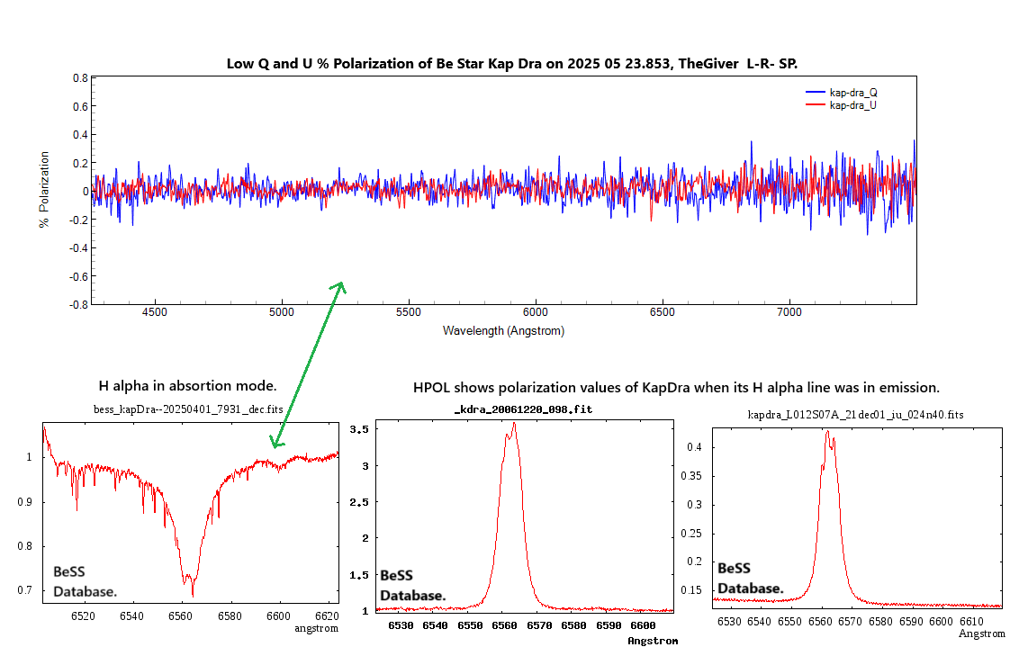

Slowly, I'm going to take more confidence, and practice with TheGiver,
it's easy to arrive at the 8 Visual magnitude.
Fortunately, it works well, you can see here two Be Stars examples.
Cheers, J. Guarro.
Cheers, J. Guarro.
- kap-dra_Q+U_20250523_853_J. Guarro.png (110.4 KiB) Viewed 72687 times
- gp-vir_%polarization+theta_20250524_962_J. Guarro.png (156.69 KiB) Viewed 72687 times

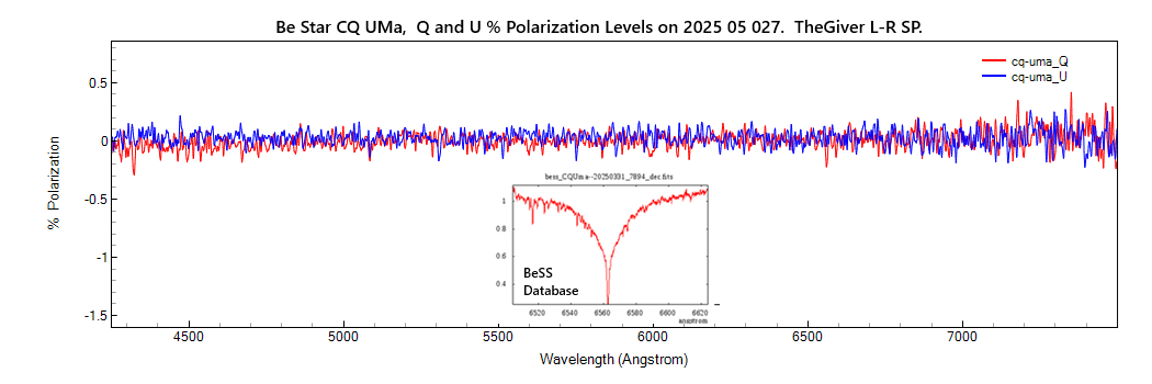

- Posts: 731

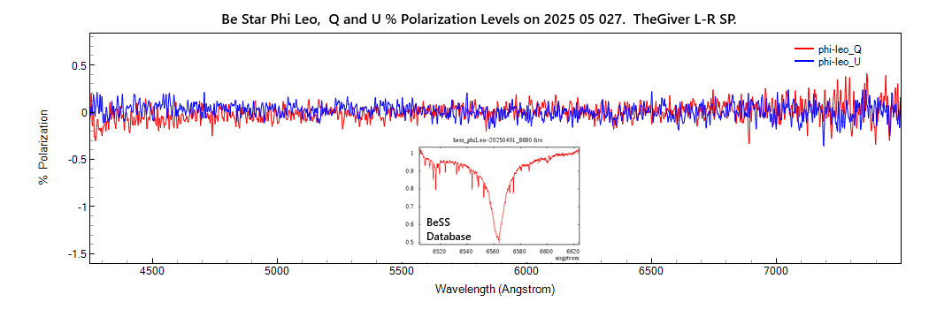

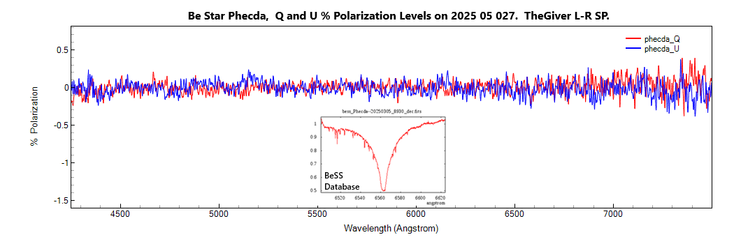

You can see here the Q and U values of weak polarized Be Stars.
J. Guarro.
J. Guarro.

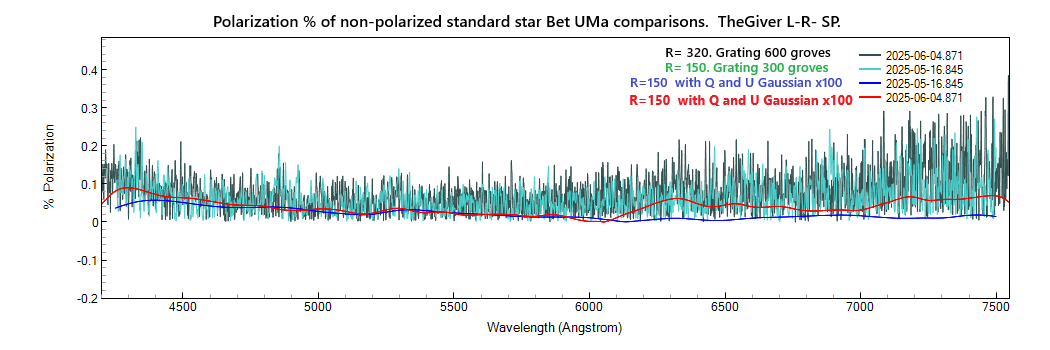

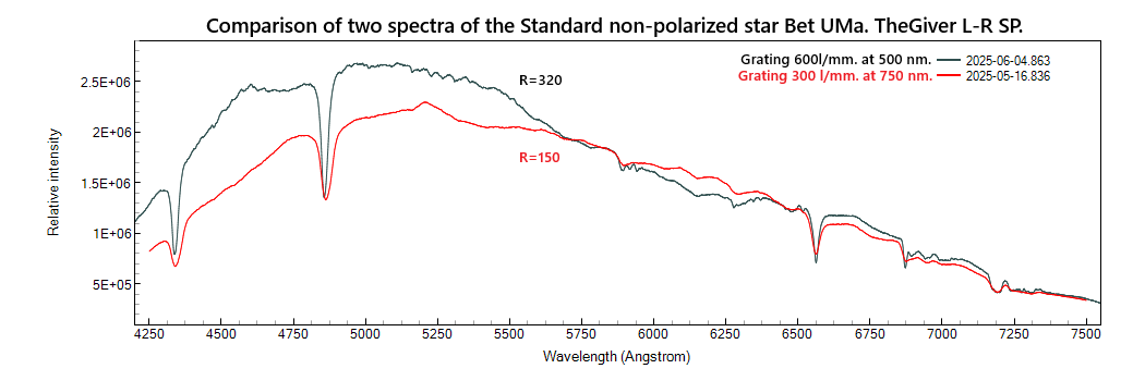

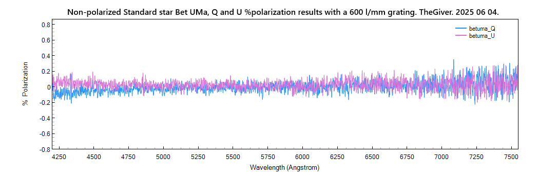

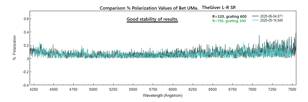

- Posts: 731

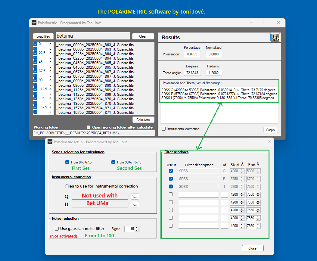

These may be the last TheGiver setups after this test time when we have received a lot of very useful advice, tips, and suggestions
from a lot of people, who without their help TheGiver haven't been possible.
In this way, I like to show you in this first picture the Polarimetric software features and options.
I would highlight the Gaussian smooth filter one, it could be sometimes very useful.
Also, it's necessary to remember that Polarimetric needs to receive the spectra FITS files processed, and it's very useful
to see and compare the outcomes by PlotSpectra. Picture one
In the way to achieve more resolution TheGiver 300 l/mm. grating, it has changed to a 600 l/mm. one, as you can see here,
Picture two.
You can see here the good stable results by two different gratings and days, also if we have had on account the bad transparency
of the sky due to cirrus during the 2025 06 04 night. Picture three.
From my point of view, we could decide from this picture the very low instrumental polarization values. Picture four.
Eventually, as a curiosity, I would like to show these Bet Uma polarization graphics and their Gaussian 100-value replicas.
We hope that it will be useful for analysts sometimes. Picture five.
Cheers, J Guarro.
Picture two.
Cheers, J Guarro.
- POLARIMETRIC.png (214.4 KiB) Viewed 72004 times
- betuma_spectra_20250604_863_J. Guarro.png (45.39 KiB) Viewed 72004 times
- betuma_%polarization COMPARISON_20250604_871_J. Guarro.png (82.65 KiB) Viewed 72004 times
- betuma_Q+U_20250604_871_J. Guarro.png (80.85 KiB) Viewed 72004 times
- betuma_GAUSSIAN100_20250604_871_J. Guarro.png (116.24 KiB) Viewed 72004 times

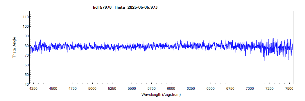

- Posts: 731

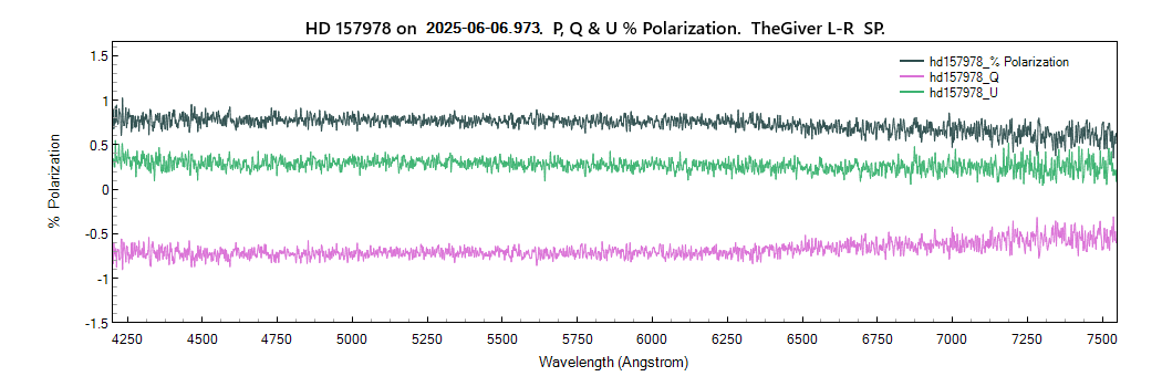

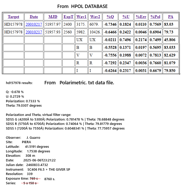

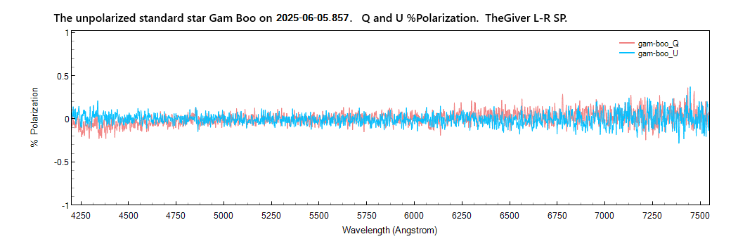

I believe that the observational training time is almost over, as samples you can see Gam Boo and HD157978 observations here.
The next target is HD161056, another HPOL database star
Cheers, JG.
Cheers, JG.
- gam-boo_q_20250605_857_J. Guarro.png (71.63 KiB) Viewed 71902 times
- hd157978_%polarization_20250606_973_J. Guarro.png (110.04 KiB) Viewed 71902 times
- hd157978_theta_20250606_973_J. Guarro.png (45.21 KiB) Viewed 71902 times
- HD157978 DATA.png (58.98 KiB) Viewed 71902 times

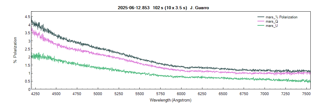

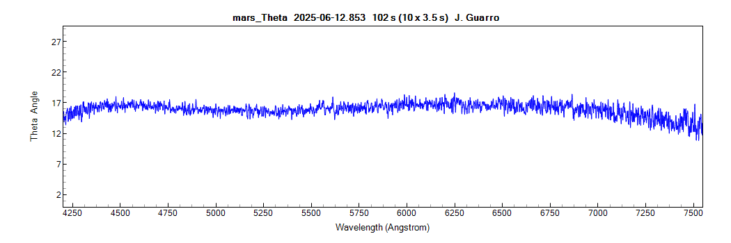

- Posts: 731
Planets and asteroids spectropolarimetry observations are very useful if one wants to tune the Theta Angle,
that is the reason that I observed Mars on this last 12th.
The provisional found values indicated that TheGiver gives -2.5º, ( 17º), off of the Mars theoretical Theta Angle, (19.5º),
for 2025 06 12 date.
I'm going to repeat these observations and also to Vesta that it has a theoretical 25.5º Theta Angle on 2025 06 18.
It seems that the instrumental Theta Angle offset needs to be controlled from time to time.
This practice is common for every spectropolarimeter.
Cheers, J. Guarro.
Cheers, J. Guarro.
