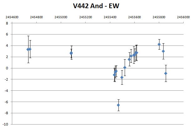

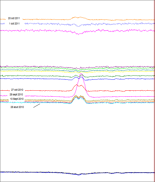

Few more curves to show past evolution of the last outburst.
In one month the emission seemed to have increased suddenly. So it is interesting to monitor the star almost on daily basis if it is a same type of outburst. This a time scaled profiles diagram, with some key dates added. Spectra come from BeSS. Atmospheric lines are removed and the heliocentric speed is corrected through Vspec.
Here is a rapid EW graph
Valerie
