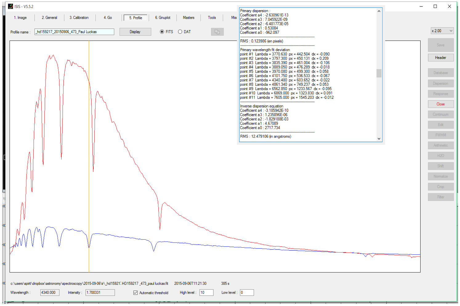

I'm experiencing some strange things working through Christian's Alpy calibration methods guide a part of commissioning a new Alpy.
Using the Balmer lines method on a nice A0V standard I get a very good result - an RMS of 0.42, and a set of Balmer lines within an angstrom or two (eye-balling) on my resulting profile. So far so good.
Then I try the pre-defined Alpy calibration module mode. Now I'm getting an RMS of 12, and resulting Balmer lines that are upwards of 15Å from where they should be. My wavelength fit deviations are all over the place, and I'm wondering what's going on here. Of note, my spectral image has quite severe fishtailing at the short end, and the corresponding neon image shows significant 'softening' at the blue end. I'm wondering if this is the cause - as during testing with the Calibration Wizard, I get an error message informing me that my "calibration error is too high" (UV on or off).
I have managed to manually compute a quite acceptable dispersion from my neon using 5 lines from 4200 to 7635 giving me an RMS of 0.052 using a 3rd order polynom, but my resulting spectra are not as 'aligned' with an A0V reference as I'd like - to within a couple of pixels, but not quite right. In fact, my aforementioned 'Balmer lines' version appears more accurate when comparing with a database A0V, hence the alarm bells (that and a reported R of 850 @ 5852Å which seems a bit too good to be true).
I'm using an 80mm fluorite doublet - so I'm not sure whether the fishtail is due to optics or my focus (though I did try pretty hard to narrow down the focus to within the Alpy's seemingly 'quarter turn' tolerance while observing the solar spectrum).

Thanks guys - much appreciate your comments. This may be more of a question for Christian, as I'm using the method outlined here http://www.astrosurf.com/buil/isis/guid ... ration.htm.
It's not a show stopper, but I'm curious as to why I am unable to get a good result using the predefined Alpy calibration mode in ISIS. Why such a large RMS ?
ISIS Predefined mode using calibration module (1 line)
The Balmer line calibration method gives me a very respectable RMS = 0.4.
ISIS Predefined calibration mode using Balmer line
Finally, here's a result using predefined dispersion from upwards of half a dozen lines from 4200Å to 7635Å (and IR corrected this time).
Paul.

Hi Paul,
Are you using the automatic line finding function in ISIS? ie you enter the pixel size, click on the position of the neon 5852 line and ISIS does the rest? If so I suspect your problem is that ISIS has misidentified the lines it uses. I also had this problem. I needed to fine tune the pixel size, rerunning until the fit errors suddenly dropped to a very low value as the lines were identified correctly. (The pixel size is used to roughly calculate where to expect the lines and presumably there is some small variation in dispersion between the instrument that Christian used to set up this feature in ISIS and the one I am using)

Hi Robin,
Yes, that's exactly what I'm doing. It's not a show stopper, but I still found it curious - particularly as the "Balmer line" method yielded surprisingly good results. I fiddled a bit with pixel size, but it didn't seem to make that much of a difference, and so suspected something else was going on. I'll take another look.
Paul

Hello Paul,
What pixel size do you enter in the General panel ? You have to be very careful with this value because it is the basis for Isis to successfully find the lines in the automatic calibration process. Christian suggests a formula to reach the correct pixel size : p = 3123 / dx where dx is the distance (in pixels) between Ha and Hb lines in a star calibration picture and p is the size of the pixel in µ.
I use the mixed method : Balmer lines calibration for the blue part of the spectrum and Neon calibration for the redder part.
With the calibration module, you could use the neon calibration method only if the picture of the neon is clearly surexposed because the blue part of the neon spectrum is too faint otherwise.

by Paul Luckas
Thanks Vincent - great advice, thanks for confirming. I will take another look at pixel size.

Hi Paul
Probably a daft question and someone will no doubt correct me but are you using an unbinned 1x1 or 2x2 binned image as I gather you have to double the pixel size if using a 2x2 one?.

I just checked a few of the ISIS txt files for some of my observations calibrated using the ALPY calibration module Ne and Ar lines only. I use an ATK314L camera with 6.45um pixels. To get a good fit with the correct lines identified I used pixel values of 6.40 unbinned and 12.80 binned which agrees well with the formula Vincent found. My RMS fit is very good, typically 0.2A unbinned and 0.4A binned. The absolute wavelength calibration is also good with <0.5A error at H beta for example. I have not tried the technique of mixing the Ne/Ar lines and blue end Balmer lines though. I am not sure there is much advantage in this though provided the Ar lines at the blue end are used
