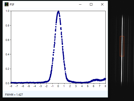

Hugh, this is a good méthod (and nice tuning)
With LISA, I used the PSF Line function in ISIS (in 1. Image)
on the green bright line of the neon (about 5400)
(always the same line)
FWHM = 1.5 was a good tuning for my setup (LISA + 460EX bin2)
So, you have a *measure* of the tuning
One can also verify how the temperature, orientation of the spectro, ... , lead to changes of the tuning

Hello, thanks for this exchange.
I am also a new user of Alpy and, after the usual presentation, this is my first message on this forum… For sure, it would be a great help to get some simple reference to quickly evaluate the tuning quality. Following Huge’ example above, this what I see on a sunlight spectrum (single image calibrated without instrumental response correction) around 5180A. Its looks not too bad but a quick PSF on the 5852A neon line shows a FWHM at 2 in bin2, still above the expected 1.5 value as described by François… The CCD is an Atik428 , same pixel size as Atik460. Good new, I still have plenty of room for improvement ! Thank again for these images.
Daniel

On ne peut pas comparer les résultats Alpy et LISA : la résolution typique du LISA est R = 1000
Je pense que FWHM = 2 avec un Alpy est un bon résulat
