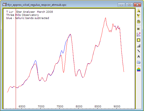

Your Star Analyser spectra look good :-) but I think the wavelength calibration for T Lyr is not quite right.
Your wavelength values look ~ 7% too high when I compare with my 2008 Star Analyser spectrum,
from this page
http://www.threehillsobservatory.co.uk/ ... poster.pdf
and with Christian Buil's spectrum
http://www.astrosurf.com/buil/us/spectro9/tlyr.gif
from this page
http://www.astrosurf.com/buil/us/peculiar2/carbon.htm

Hello Gerard,
Your Vega wavelength calibration is good so you can use the same calibration for T Lyr. Use the position of zero order (= 0 Angstrom) and the same dispersion (A/pixel) that you found for Vega.
You can see an example of this using Visual Spec in this presentation (slides 36-46)
http://www.threehillsobservatory.co.uk/ ... p_2008.pdf
