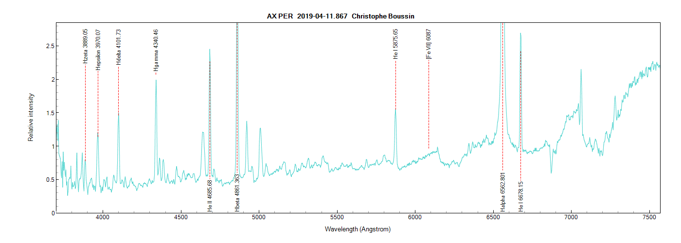

Hello Francois,
I obtained the following spectrum the 11th of April at 20 h 49 TU with a resolution of 507 (JJ = 2458585.3675) and an acquisition time of 30 min :
AX Per on April 11th, 2019
_axper_20190411_867_Christophe Boussin_3700_7570.png (77.92 KiB) Viewed 10663 times
As an indication, identification of some lines :
AX Per on April 11th, 2019 (identification from PlotSpectra)

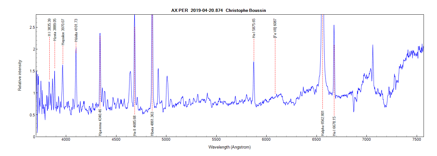

Here is my last contribution to the monitoring of AX Per outburst.
I obtained the following spectrum the 20th of April at 20 h 58 TU with my Alpy 600 (resolution of 505, JJ = 2458594.3738) and an acquisition time of 30 min :
AX Per on April 20th, 2019
_axper_20190420_874_Christophe Boussin_3700_7570.png (80.16 KiB) Viewed 10575 times
AX Per on April 20th, 2019 (identification from PlotSpectra)
