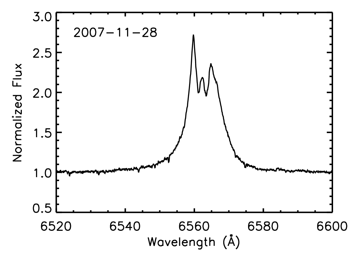

For comparison, a triple-peak spectrum from 2007-11-28 in:
CHARA Collaboration Year-Five Science Review by Gail Schaefer (CHARA / GSU)
