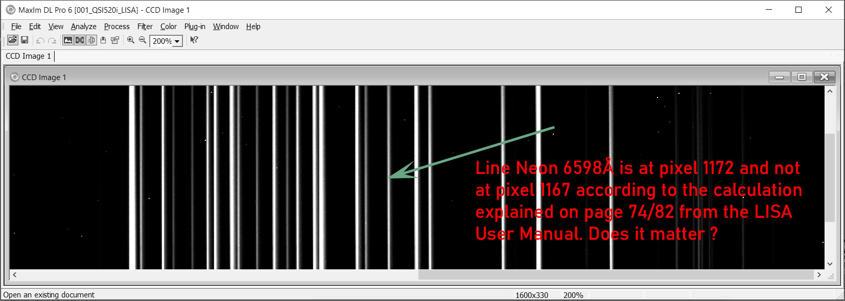

I have a LISA and my camera is an old reliable QSI520i and I ahve followed as good as possible al installation steps according to the user manual.
One thing bothers me a bit. According to the calculation the Neon emission Line should be in the position pixel 1167 but after hurs of trying to get it there I was able to leave it at pixel 1172. Does that matter ? Just by tightening the locking screws it moves ... I think I will develop a stepper motor adjustment for the lever :roll:
Thanks for any tip
regards Rainer

Hi Rainer,
That is close enough. Don't worry about it.
It is a very frustrating adjustment to make on the LISA. You did well to get that close!

Hi David,
Thanks. I will not touch it again ;) and now focus on getting good calibrations testing different ways.
