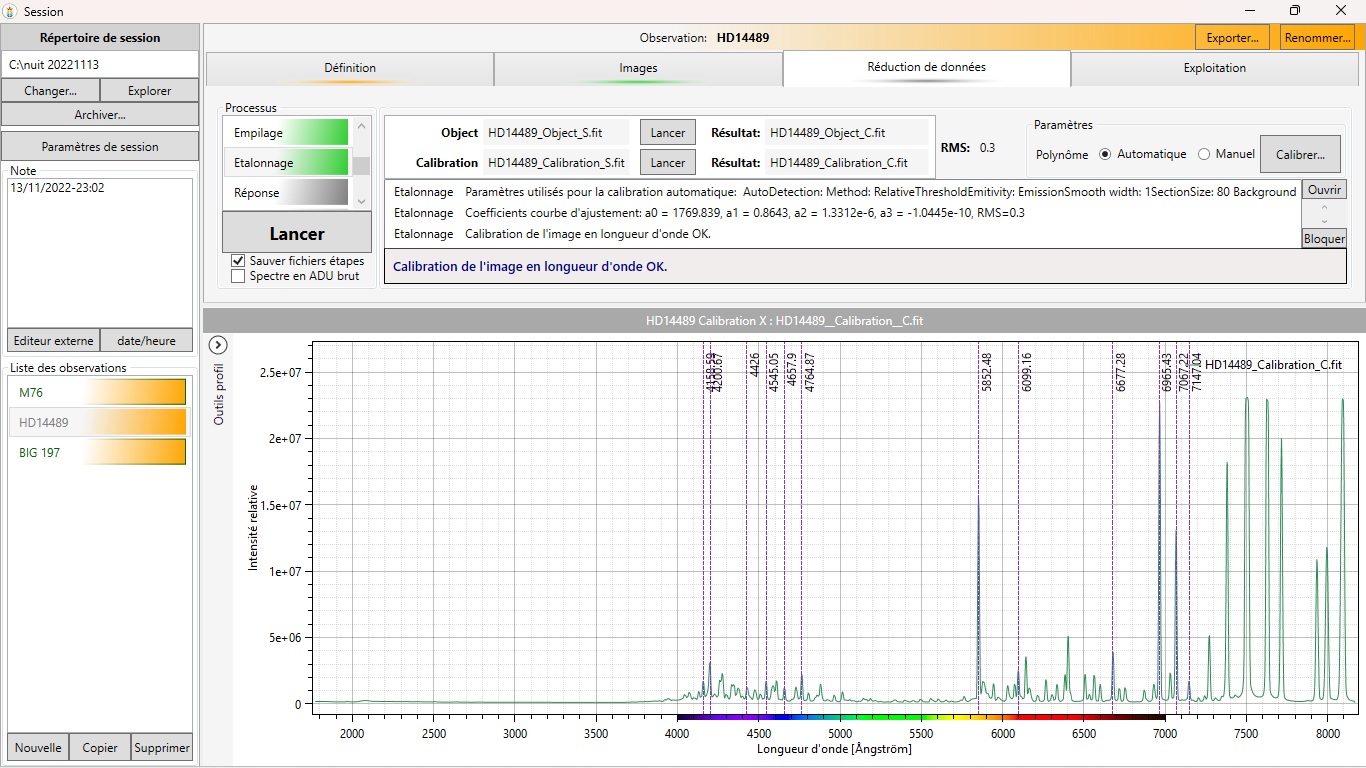

Alpy 600 wavelength calibration is correct (see dem_1 pic)

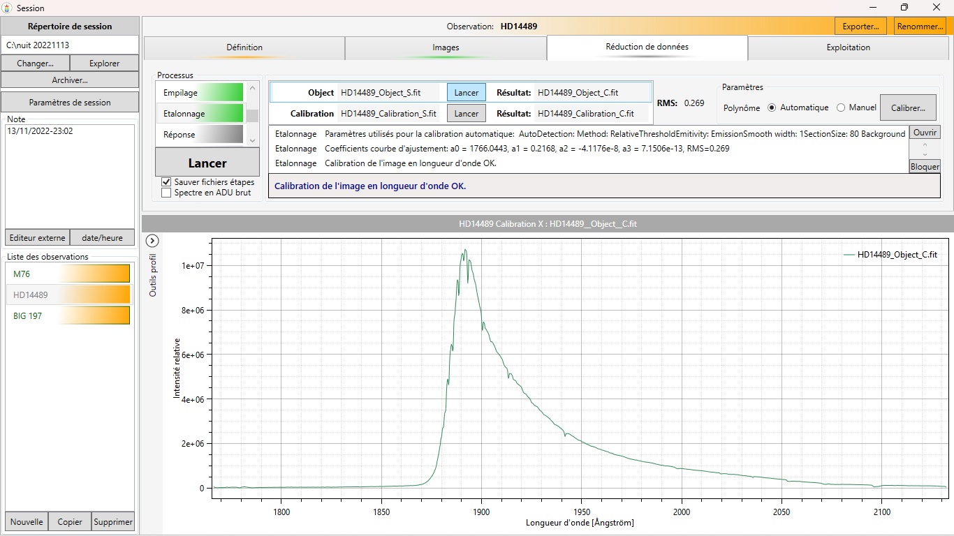

But when you click Launch to perform the object calibration process, wrong values appear on the X axis.

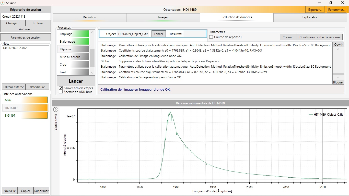

See dem_2 pic (X-axis in pixels) to dem_3 pic (X-axis corresponding to ????)
Therefore, the instrumental response operation is not possible since the image is not properly calibrated in WL. (pic dem_4)

Bad use of myself. Process should be executed as follow :
1/ Object calibration >> Go
2/ Neon calibration >> Go
I was doing the opposite, which resulted wrong results.

The designers inform me that this is indeed a bug they are working on.
