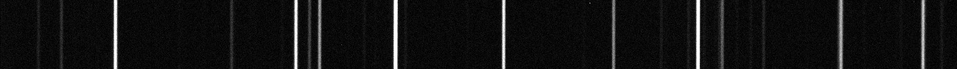

I'm using the Genesis 4" f5 Petzal, a 29micron slit, the Spectra_L200 with1200 l/mm grating. (Doesn't seem to matter which grating - the slant is seen with 300 l/mm) and the ATik314L (1 x 1 binning)
The imaging camera is well focused on the neon lamp lines, and the PHD guiding seems OK...

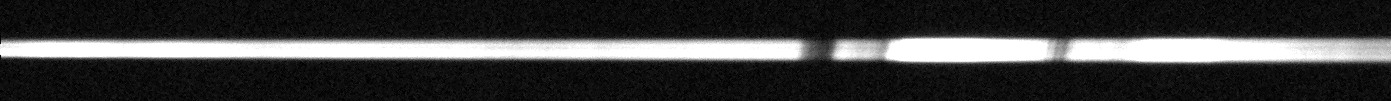

When the spectrum is slightly extended 10-15pixel high, you start to see an abnormal "slant" roughly 15 degrees (!!) this doesn't correspond to the ref lamp slant etc.

Obviously when the spectrum height is reduced, it's no longer obvious.....

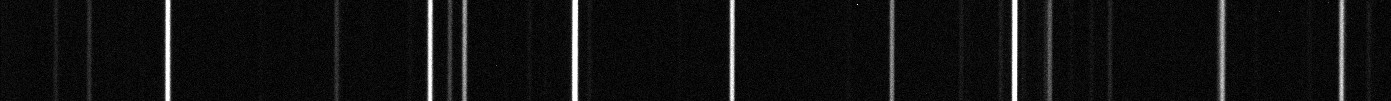

I attach a typical ref lamp image and a recent V1369 Cen image to show the effect.

Hi Ken,
Yes I recall seeing examples of this effect seen with the LHIRES. Is it all the way across in the same direction or just at the edges of the field? If just at the edges it can be due to the doublet with a wide field and slow optics. eg see this page on Christian's site
http://www.astrosurf.com/buil/lhires_eval/optique.htm
I believe correct collimation has a bearing on this too. There is a post somewhere on here (I think by Martin Dubbs) investigating these effects.
