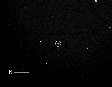

Posted: Sun Jun 15, 2014 12:30 am
Field of view

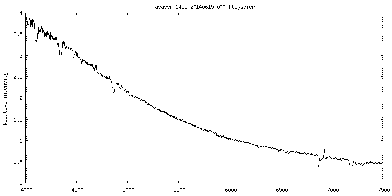

Re: Transcient ASASSN-14cl
Posted: Sun Jun 15, 2014 1:21 am
CV in outburst, with noticely He II in emission
Line at 6926 is a cosme, not removed
Posted: Mon Jun 16, 2014 10:22 pm
by Tim Lester
Congratulations François!
I was able to get a spectrum through high altitude haze on June 16th (calibrated using HD208906 and the Miles spectrum).
Don't seem to be picking up the He II emission... :?:
Posted: Wed Jun 18, 2014 7:43 pm
Thank you Paolo and Tim.
The changes in spectra of DN in outburst are very fast.
See for instance SS Cyg : http://www.astronomie-amateur.fr/feuill ... 20Cyg.html
However I'll verify my images.
Could you send me your spectrum for the database, Tim?
