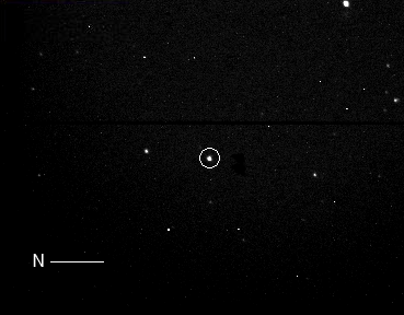

Detection of a bright transcient (mag 10.7) ASASSN-14cl
AD 21 54 57.6
DE 26 41 16
ATel 6233
http://www.astronomerstelegram.org/?read=6233
Perhaps a CV outburst
Re: Transcient ASASSN-14cl
Field of view
CV in outburst, with noticely He II in emission
