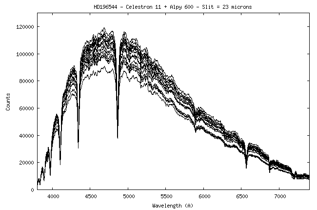

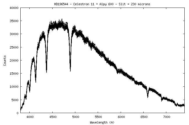

Really, with LISA (in my exemplary models) the slit is prefectly focused after many removing. You have tested ?
The principal source of error is the 23 microns wide slit. Look the attached plot:
Seeing1 : dispersion of intensities value with a 23 microns slit on Alpy (equivalet to LISA), C11 f/7. 12 sec. exposure each
Seeing 2 : dispersion with a very large slit 230 microns (equivalent to remove slit). 2 sec. exposure
The residual fluctuations in the seeing2 plot are the consequence of atmospheric scintillation because exposure time
is very short (situation is better in seeing1 on this point).
The photometric error is much lower in seeing2, of course. Contain of this page is not a fiction unfortunately:
