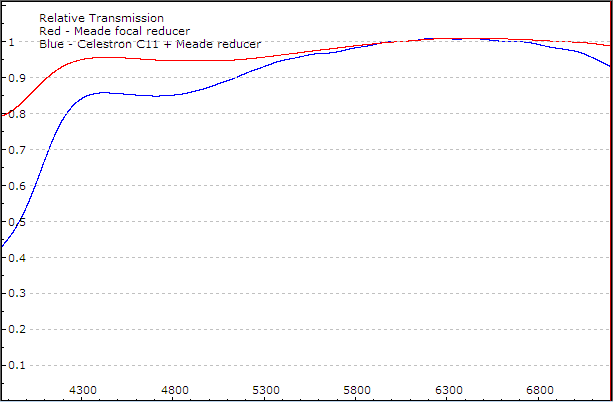

Hello Christian,
These transmission results are very interesting to me as I use a Celestron C11 (~ 10 years old, not the current design). I also use a Meade focal reducer with the ALPY so I have now made some similar measurements based on Halogen lamp flats in front of the telescope and in front of the ALPY off the scope.
1. C11+reducer+ALPY
2. ALPY +reducer
3. ALPY only
I then calculated the normalised transmission curves relative to the ALPY only as a reference.
The proportion of scattered light in the ALPY is significant at short wavelengths where the halogen lamp output is low. (I subtracted this as carefully as possible) so the results probably will not be as a accurate as yours using a hot star (I do not have a good reference telescope). My results do suggest that my Meade reducer may not be as bad as your Celestron reducer though.
Re: A modification for improve eShel spectrograph
The reflection from the coating on my C11 corrector plate is strongly blue/violet. It suspect most of the transmission loss at short wavelengths in my system may come from here.

Robin, the front corrector plate of a SCT can effectively block some UV rays (your observation). But I think that on the recent SCT, the effect is limited, I have the impression that often the problem concerns the reducer. The visual blue reflections on the corrector plate do not necessarily indicate a blocking of the blue rays: with an antireflective coating no optimized for a given wavelength, the reflexion coefficient is that of the bare glass (about 0.92) but does not stop the bleu/UV light. The problem noted on the tested reducer is the presence of a specific coating which rejects blue/UV rays, it is not the same thing.
