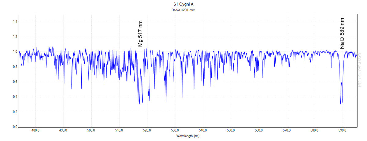

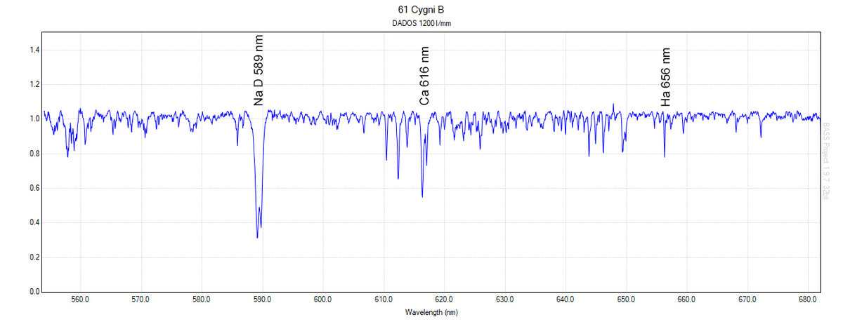

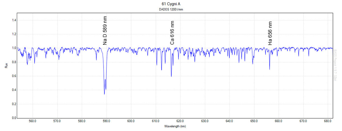

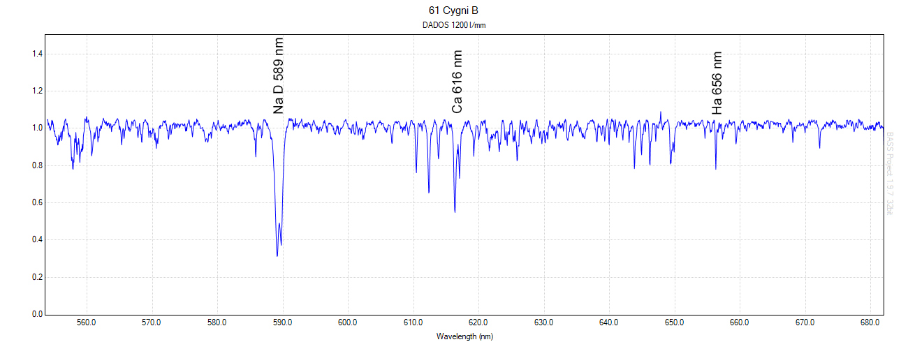

Hi!
I would like to present the first spectrum I got in collaboration with my students Maximilian and Elina (both 16). It's a spectrum of 61 Cygni obtained with a LX200 10" SCT reflector, a ST-10XME and a DADOS spectrograph with a 1200 l/mm grating. The exposure time was of 3 times 5 minutes for each star and each wavelength range, so 1 h in total. I has been calibrated using an Ormalight 9W energy saving lamp and reduced with BASS.
I would be happy to get suggestions and maybe a recommendation about the easiest way to identify the lines we see in the spectrum.

Re: 61 Cygni
Nice start. Identification of lines can be difficult. You could try looking at a solar atlas (several are on line e.g. http://adsabs.harvard.edu/full/1995ASPC...81...17K ) or try Richard Walker's Spectral Atlas for Amateur Astronomers, Cambridge University press where I think he used the same spectrograph as you have.
Regards Andrew
Regards Andrew

Re: 61 Cygni
If you want to find the spectra class of a star this is the best place to start http://vizier.cfa.harvard.edu/viz-bin/V ... ource=B/mk
Regards Andrew
Regards Andrew

Re: 61 Cygni
thank you Andrew! I know about Walker's Spectral Atlas. That is indeed very useful. I'll also give a look at your link.
Some days ago I've ordered this book:
http://www.cambridge.org/gb/academic/su ... BtGbfmW.97
Hope this will help!
Best wishes
Christof
