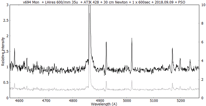

Opening the new season for v694 Mon: a fresh, lucky 1x10 minuter at the lowest level I can shoot v694 Mon from this morning - the P-Cyg profile has mostly vanished (a very rare state), uncovering a blue wing:
Fresh 1 x 10 minuter
Had to wait like 30 minute to rise above a tree, and had to move the next 10-minuter to trash because of too much sunlight contamination and poor guiding against rising sun.
The two wings confirmable visually on the raw image, and the removed background is a bit contaminated by the Sun's H-beta absorption (that is narrower than the wings).
I'd appreciate if somebody could confirm the existence of the blue wing, as once I've had hard times to prove such a validity for a professional.
- Peter
Re: V694 Mon revisted
Interesting, Peter
You've an the blue end of the line in faint emission
The last spectrum obtained by Umberto shows a very weak blue absorption

Today morning's result - similar, in a better quality (5 x 10 mins):
This SNR would allow high resolution (maybe next time).
A narrow absorption is definitely still there (as previous result suggested).
- Peter
