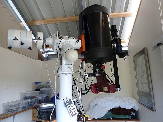

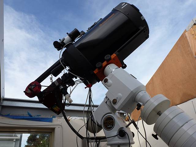

Etienne,
The C11 is a popular choice for spectroscopy and fits well on an NEQ6pro mount.
I use the Spectra-L200 plus ATik 314L on my C11 controlled by a Lodestar guider, using EQMod and CdC.

Thanks Ken for the photo, i think C11 is a good/best for the EQ6.
